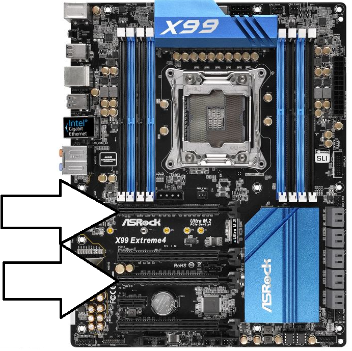

What slots are you using? I'd try these two if i were you. The middle one can be funky i imagine becasue it might be linked to the M.2 or whatever port.
Hey, yup those are the two slots I was using. That is PCIE1 and PCIE3. But unfortunately I can't fit my 970 100ME in PCIE1, so the 750 TI had slot 1. Although IDK why that would be an issue.
