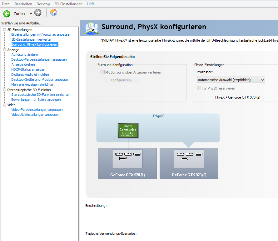

I have the problem i have two GTX 970 from MSI 4G (both are from the same manufactory)
I actually cant Enable SLI, cause its not shown in the Nvidia Driver Settings, where it should have been.
I'M using Windows 8.1 and my mainboard is from MSI Z87-G45 Gaming, The slots are okay and both cards work as i tried both, GPU Z is also showing me both cards, even the nvidia driver shows me both cards but it doesnt let me SLI them.

Is your pcie ssd a x1? If it is pcie x1, then you can put it on any slot......oh I see the problem. SLI requires x8 x8, but with the ssd, it becomes x8 x4 x4 even though that is x16 x8 x8 in pcie2. nVidia and their silly SLI requirements that Linus kinda ranted about.
So my budget is currently 0, i would go for an upgrade in the coming months, 2 or 3 months till i have the money for it, I still ahve another sata SSD but the Raidr was just something special, and yes my ssd is such one which needs a Pcie 3.0 the funny thing is my mainboard runs at 8/4/2 when i put everything in, and sli cant be used, very sad, and much more sad that my better system which was more optimized, is on the Raidr :(

it because of the SSD on the 3rd PCI-E slot
the bandwidth becomes x8x4x4
SLi need x8x8
