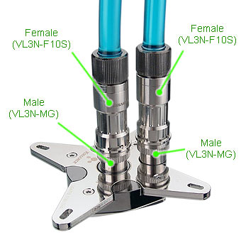

Quick Disconnect fittings are awesome for replacing components in a loop or creating an easy way to empty your loop.
For example, just put a quick disconnect in the loop at it's lowest point (preferably just before the pump-reservoir), and leave it there. Since the fitting can be taken off while the loop still has coolant in it, it can easily be used to empty the loop later when necessary.
When you do want to empty the loop, get another quick disconnect fitting and attach it to the one you disconnected from the series in the system with a bit of spare tubing attached to it to easily empty your system without having to move the whole rig, or having to have an unsightly piece of tube going no where in your case.
Do note that having quick disconnect fittings in your loop add resistance, albeit small, it can add up if you have a lot and may want to consider dual pumps to increase bulk head pressure to overcome the resistance.
Picture example of a quick disconnect fitting in place with a CPU block:
Picture xample of a Quick Disconnect fitting in a loop, disconnected from the series:
