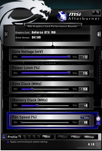

So, when playing bf4 sometimes my gtx 970 starts to thermal throttle at 50°C. It downclocks itself to 899 mhz, this happens at least a few times a day and it takes no longer than 15 seconds. I have no idea why this is happening, I've overclocked it but that overclock was running stable for the past 2 months so I don't think that that is the problem.

Thanks for the reply but my templimit is already maxed out, and I want to keep the semi-passive design at idle of the gpu, but I will adjust the fancurve to make the fans start to spin from like 30°C or so. I hope it will help. Thanks!
