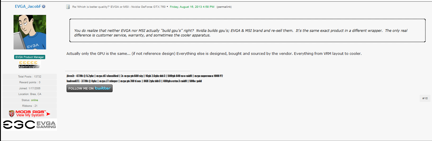

I found an actual vendor answer to this.
