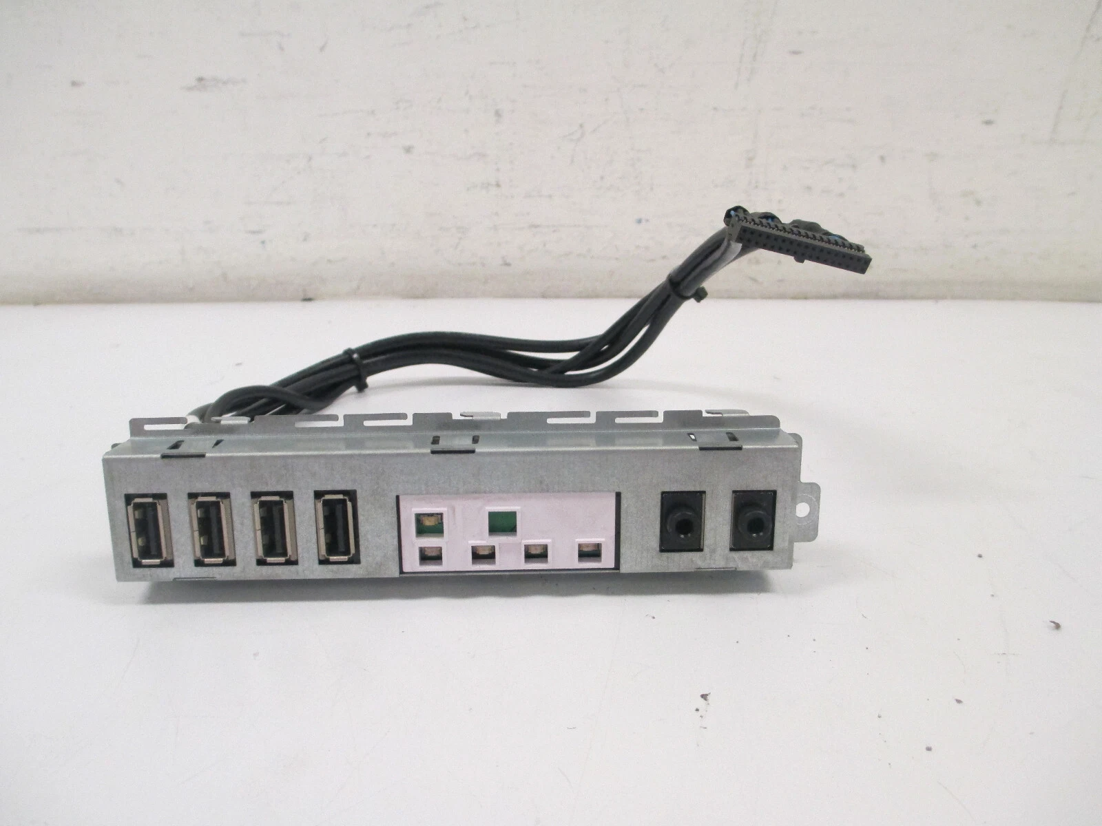

Apparently the biggest pain is the front panel connector with everything going into a single non-standard size 34 pin connector. The black connector between the SATA ports and the back panel. (not my opti 790 board pic)
Genuine Dell Optiplex 790 Tower Front I/O Panel Assembly 0G3XVD - Picture 1 of 5      optibord.jpg.e951957fcfeddb700a2ed94ea925643f.jpg
But there are adapters available if you want to stick the Dell board into an aftermarket case;
34968D1DF7D649438E27955C31FD1C-56fa9094-581AF2CB505F470FA935FD5049AB93-c695fb5f-d3ad-48bd-a1b3-d4f6d4f128a1-123109377.jpeg
My thought is the adapter is most likely a simple pass through rerouting the connections, so in theory I should be able to plug the FP connector and the adapter pcb into a male to male adapter;
and then the motherboard connectors onto the adapter.   So the front panel stuff should still be able to work with the new motherboard (except the diagnostic lights)
Same thing, just in reverse.
Any reason why that wouldn't work?

some connectors might just be a connector well others might have some odd signal.  like the dell 5pin fans...just depends on how much they go out of there way.
you need to find the pinout to each think to make it work. were the usb wires is, were the led lights is, where the audio is.
the mb mount not be stander too some times it is some times not. imo easier to just get a case.

I shouldn't need to worry about the pinout, that's what the adapter is supposed to do, reroute the paths.
oh i thought you going to make your own so what is the problem? oh i think the adapter is to use the mb in a different case?
you would then need audio cornerstone internal usb connectors, and DuPont for led.
can use dupont for the others i think too.
need a place to put or mount the adapter, wires, solder, heat shrink, and iron.
usb might be usb 2.0 too.
