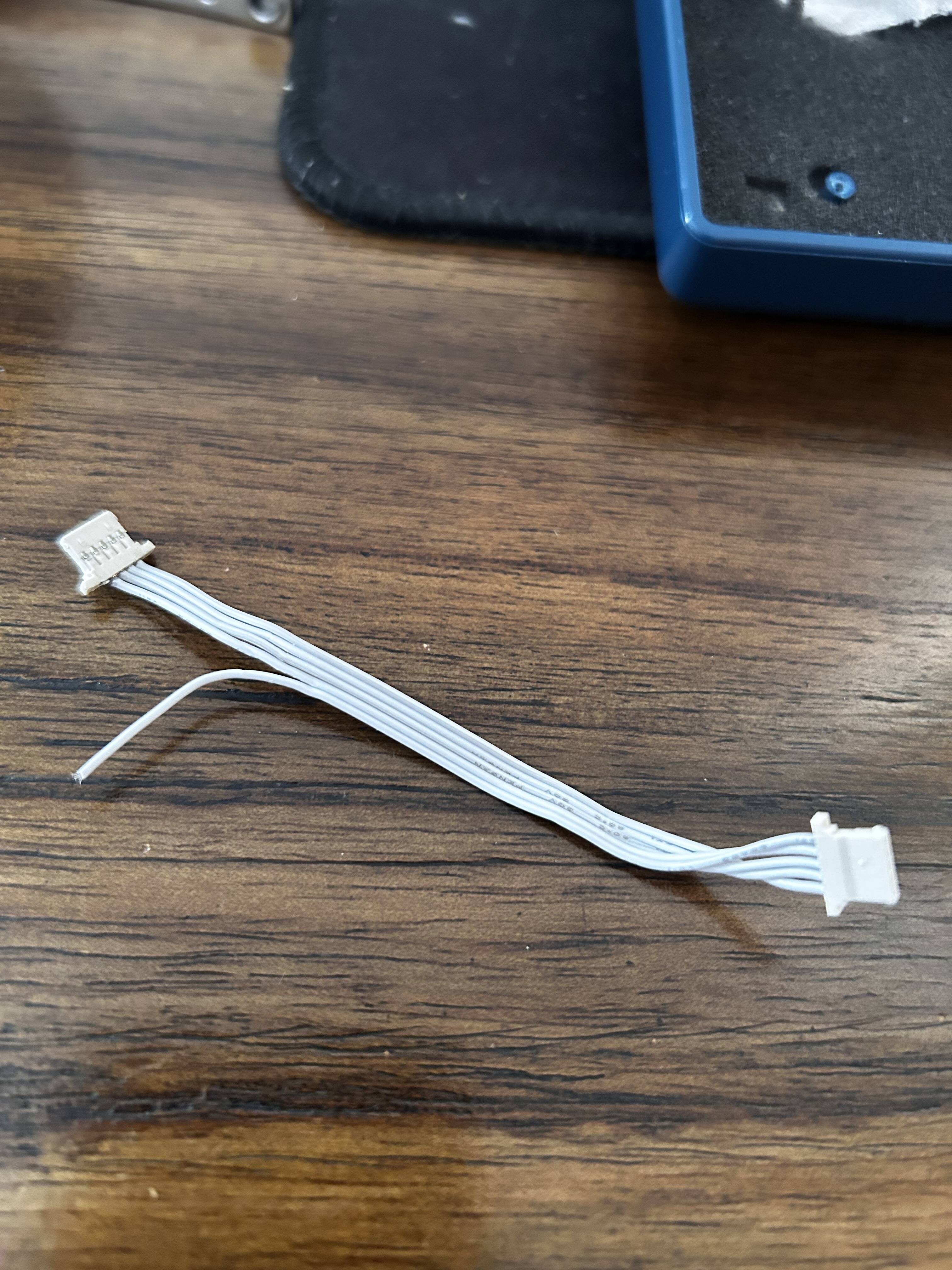

How to fix this cable?
Go to solution Solved by Biohazard777,
1 hour ago, ProSouvlaki115 said:
And if not, is there a usable alternative I can find on Amazon or aliexpress since the cable is actually detachable?
That looks like Molex 51146 to me, so:
https://www.aliexpress.com/item/4000818221650.html
(make sure you select 5P , 5 pins/wires... and obviosly don't buy just the connector, buy the male one with wires attached)
https://linustechtips.com/topic/1617371-how-to-fix-this-cable/#findComment-16764043
11 minutes ago, ProSouvlaki115 said:
Does the listing you provided come with connectors on both ends?
No you'd have to manually make one male to male out of two of these (or just 1, if you use the ok part of your old cable).
Simple enough though, strip them, twist together (solder - optional, if you have the tools great if not it will work fine without soldering), electrical tape, do that 5 times and you got your cable.
There are listings for male to male, but  way too long for your use-case, 1m:
https://www.aliexpress.com/item/1005009165733638.html
(and more expensive, but if that is ok with you: pick same direction - as that is what your original cable was)
Try searching a bit on your own, maybe you find something shorter.
https://linustechtips.com/topic/1617371-how-to-fix-this-cable/#findComment-16764051
