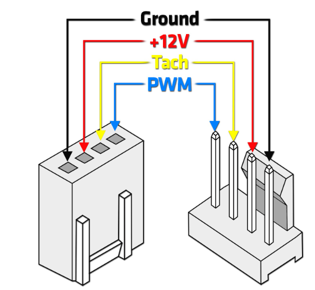

This is a fan power connector.  Notice the boxy shape, and the "locking" tab on it:

Do you think its worth it to get a 3 to 4 pin cable rather than getting this?
https://linustechtips.com/topic/1605675-complicated-pc-fans/#findComment-16684673
rather getting what?
https://linustechtips.com/topic/1605675-complicated-pc-fans/#findComment-16685036
that's for fan power, that's not RGB.
If you plug 3 pin ARGB into RGB you will burn out your ARGB devices.  DO NOT DO THAT.

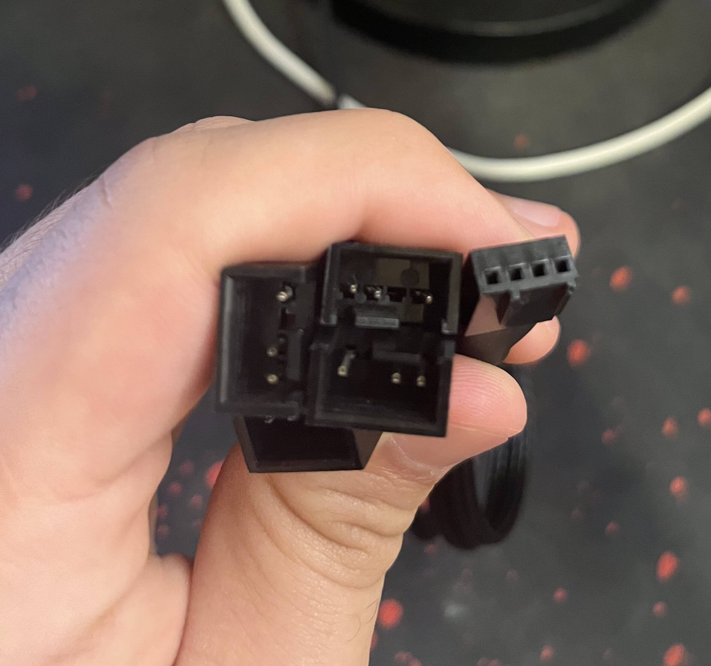

the deepcool converter, I got a cable from a friend and I'm not sure if this will work, it looks like a 4 pin RGB connector and 3 3-pin ARGB connector

I really dont mind having limited RGB control, I only want it to stay at one color, will the RGB to ARGB converter allow me to do that?
https://linustechtips.com/topic/1605675-complicated-pc-fans/#findComment-16686416
it make the argb act like rgb so you can use your mb to control it. some of the convertors has presets on them. but rgb is prity basic to control.
99% of people that buy argb just run a solid color because they gave up on the addressable part... cant blame them...
