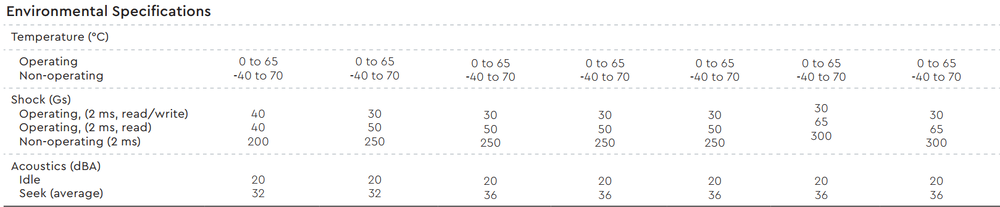

EDIT: One of Seagate's data sheets shows an operating temperature range of 5 to 60 degrees C, so I would expect -15 degrees C for non-operating conditions to be within the proper range of the drive.

Don't know exactly what drive will be inside it, but it will likely have a non operating temperature range of -40-70°C:
https://www.seagate.com/content/dam/seagate/migrated-assets/www-content/datasheets/pdfs/ironwolf-pro-14tb-DS1914-7-1807US-en_US.pdf
