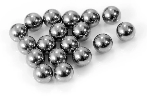

It happens to me that I take on the repair of devices that I do not know. When I was disassembling the entire derailleur mechanism in this bicycle for the first time, to grease it when they squeaked a lot while riding, all the parts flew out right away that I didn't know how to assemble them and in my spare time for a few hours a day for a week I would assemble it. On this bicycle is in such 2 parts on the left and right parts of the derailleur
the plates that hold the balls were crushed, I put the balls manually in the place where the circle in the balls should be and I threw the crushed plate away, but when I put the balls in, there was a free space, I put balls from other broken bicycle bearings in this free place, but if you spin the derailleurs again, then these balls fall out and you have to be careful not to lose them, is it possible to buy such a part but I noticed that these wheels are of different sizes the same and in the derailleur a small type of balls and in the pedals a large type of balls what about that I have spare wheels with balls if the size does not fit.
Is it possible to buy just this small balls?
is it better to buy such balls mounted in a circle?

As for that bearing, what did you take apart exactly? I've seen those in the crank housing, and pedaling feels 'crunchy' when they go bad. Don't try to just replace the ball bearings, because that won't last. You need an entire bearing, which shouldn't be much more expensive anyway. You'll want to completely pack the bearing with fresh grease, then add more grease to the crank housing before reassembly.
