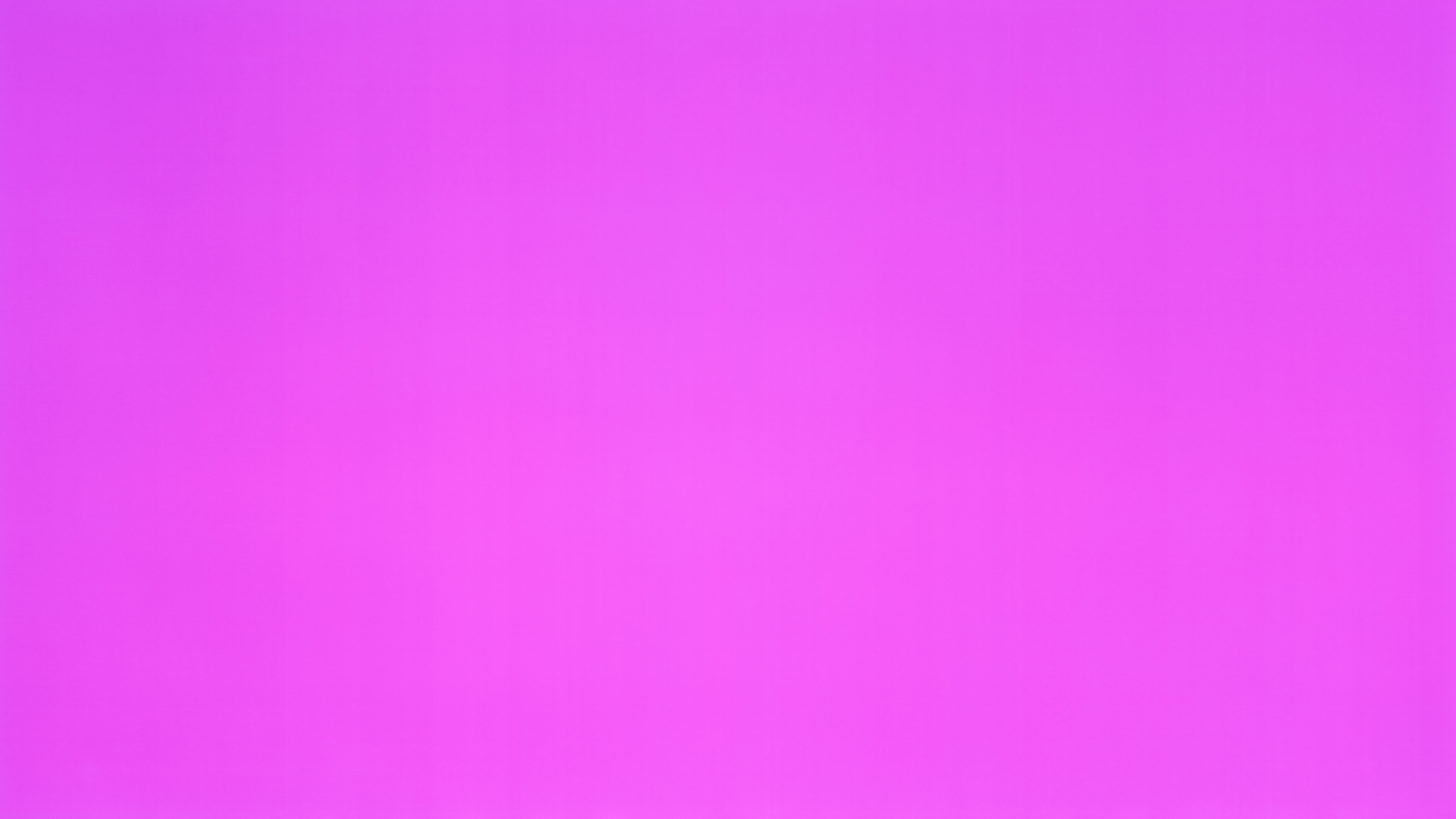

Careful about ur expectations.
LCDs are far more durable than OLEDs, and it will really depend on how u treat an OLED and how many hours per year u put into it as to how long it lasts.
If u play games with subtle UI's, and vary your content, u can put 10,000 hours in and be fine.
Week 102 (20/7 COD:WW2, 14,280 hours)
real-burn-in-week-102-tv-0-magenta-large

NOTE : these test were done with the older generation C7 OLEDs, playing the same content over and over for 20 hours a day every day) newer 9 and X generation models are more durable, but still susceptible.
