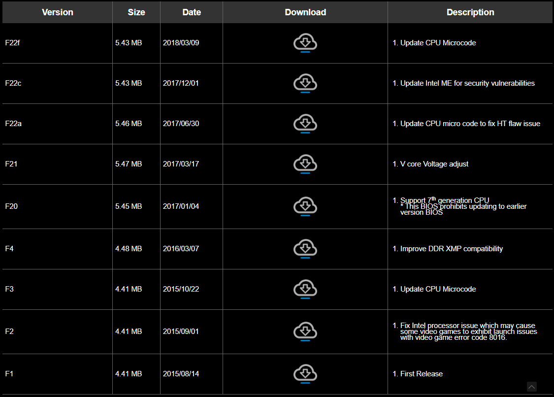

Should the newest BIOS update be adequate? His PC was bought back in like 2016.0d83444b44c58a2ece5288a7aa213625.png
https://linustechtips.com/topic/1197648-two-different-ram-kits/#findComment-13625929
F22f is ideal, F4 specifically mentions fixes. So you need to be F4 or above.
