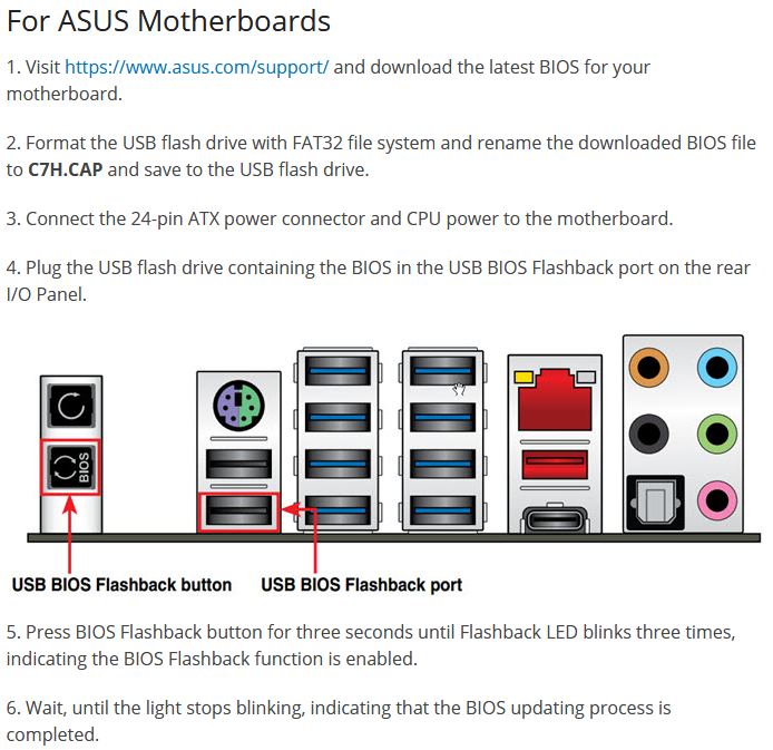

Booting? You're not supposed to be booting anything. With your PC off but plugged in (like you've just flipped the switch at the socket but not powered on yet) just insert your USB into the flashback port, press and hold the button until it starts flashing, let go of the button and let it flash. When it's done the LED will stop blinking. Remove USB and boot.

You sir, are a blessing. I did exaclty as you said and im finally booted up and running. I really appreciate the help, Cheers!
