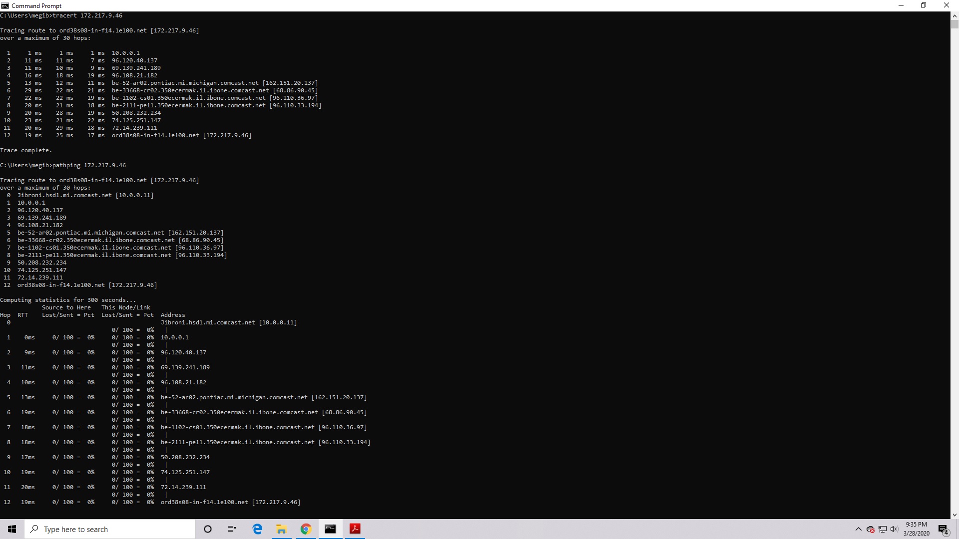

I reseted the modem 3 times and the router 2 times. Im using ethernet for my desktop. I tried connecting my computer directly to the modem. The packet loss occurs both on my desktop and phone.
Yeah, your results should look like mine if the connection is working as intended. I would try using the pathping command as shown below. Its basically the trace route and ping commands in one. It gives you more information about exactly where packets were lost along the route. The first hop will be your modem/router. If it gets past that stage with no packet loss, then you will know for sure if the problem is on their end, and I would just contact your server provider. You can even tell them exactly where packets were lost when you did your pathping command.
