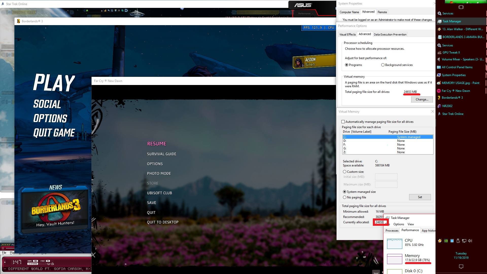

19 hours ago, supremedutchgamer said:
tried just setting it to 8000MB first, that didnt help. did the system managed one, and it set the paging file to 32 gigs... dunno if it is fixed now, but thats a pretty large amount of space for a paging file.
Sounds about right.
Mine reads: 24653MB and I have 24 GB of RAM.
It changes dynamically for what you have open.
Have not tried yet to see if making all drives (have four -excluding boot partition) would help or hinder....
Proof of it working and no low memory message:1651101265_MEMORYUSAGE.thumb.jpg.62d1cb328e40759924e87784910b5aeb.jpg
