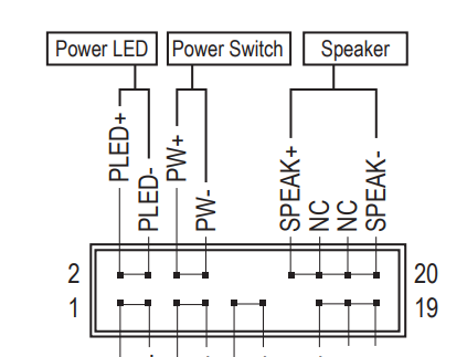

on most boards, there are little markings near the connectors. try looking for small markings that say stuff like "-PWR SW+" (Power Switch) and "-RST SW+" (Reset Switch). make sure to line them up correctly, and not plug them into the wrong places. on the cables that are connected to the case you should look for a small black arrow at the tip. this arrow indicates that the side that it is on should be connected to the side where the "+" symbol is on the motherboard.

The pwr_switch header for the case connects to the power switch pins in the group of pins labeled f_panel.
It's the top right of the 9pins and is color coded in red.

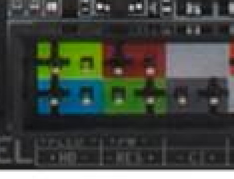

I just couldn’t find a place to plug them in because I’m total the front panel has 8 holes and I could only find plugs with 9 pins. Also the car says usb where the pins are what does that mean and is that where I plug them in
Car?
Do you see the f_panel label? The group of headers are at the top right of it or above the f_panel layout diagram on the motherboard.
