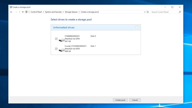

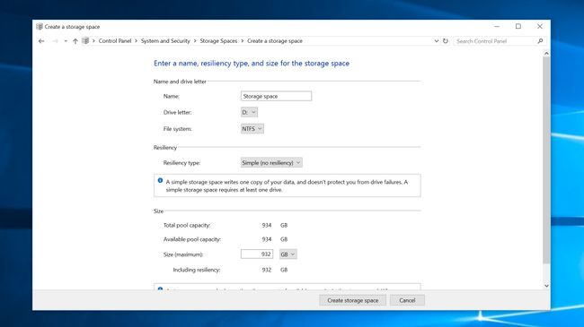

It looks like this(not my screens)
And that creates a jbod pool of 2 disks. When i tried it, it was immediately evident that something was wrong as the transfer speed was much lower than what it should be.

RAID 0 in Storage Spaces is called Simple. Storage Spaces doesn't do JBOD (more correctly called SPAN), everything is split in to chunks and distributed across disks in the pool based on the configuration you set.

New-VirtualDisk -FriendlyName $SpaceName  -StoragePoolFriendlyName $StoragePool -NumberOfColumns 1 -ProvisioningType Thin -ResiliencySettingName Mirror -Interleave $InterLeave -Size 500GB
Replace the storage pool with the name of your pool, number of columns with the number of drives you have, and set mirror to simple, and set size to what you want.

As for performance make sure the column width is 2, for both disks. Also give this a try, Set-StoragePool -FriendlyName "Name" -IsPowerProtected $True.
1 minute ago, leadeater said:
When you put the disks in to a Storage Spaces pool you aren't even supposed to be able to see them in task manager, only disk you should see is the virtual disk created within the pool.

Mostly because his picture only showed two disks, I max out at 8 since that's the limit of most drive bays and standard HBAs plus it impact how many disks you need to add to the pool to expand an existing virtual disk. Small column width good for expansion/flexibility but bad for performance, wider is the inverse of that.
