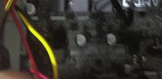

2 minutes ago, Oshino Shinobu said:
Doesn't look like the EPS/CPU power connector is plugged in. It's a 4 pin connector, just above where your thumb is in the photo.
I do see that, in which I find it odd that the system beeps unless of course its a beep code

1 minute ago, Oshino Shinobu said:
Was it plugged in? Kind of hard to see in the picture.
You can see its connected, barely though.

11 minutes ago, Oshino Shinobu said:
You can look to see if there are any CMOS clear jumper pins on the motherboard (it will be in the manual), or you can remove the CMOS battery for a while, then put it back in. CMOS battery is the CR2032 flat cell in the middle-left of the board.
This is the pin right that I should short
https://linustechtips.com/topic/988064-new-bulid-no-display/#findComment-11902098
You can try shorting it, then try booting again. If it won't boot, then you'll need to update the BIOS.
That will require access to a working 1000 series CPU, or you'll need to take it to a shop to get them to update it.
Did remove the cmos battery and turned on again but same thing single beep and nothing
