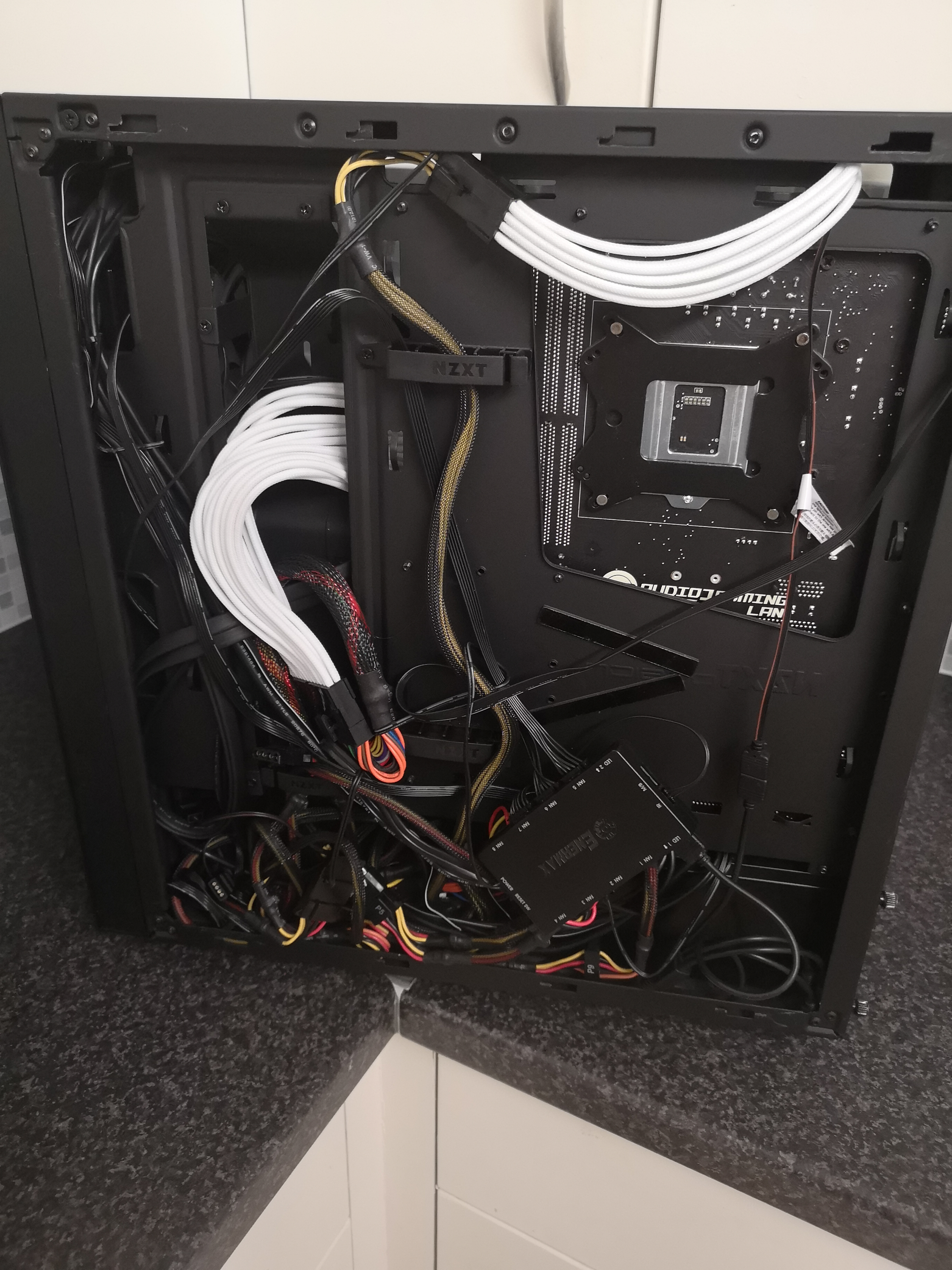

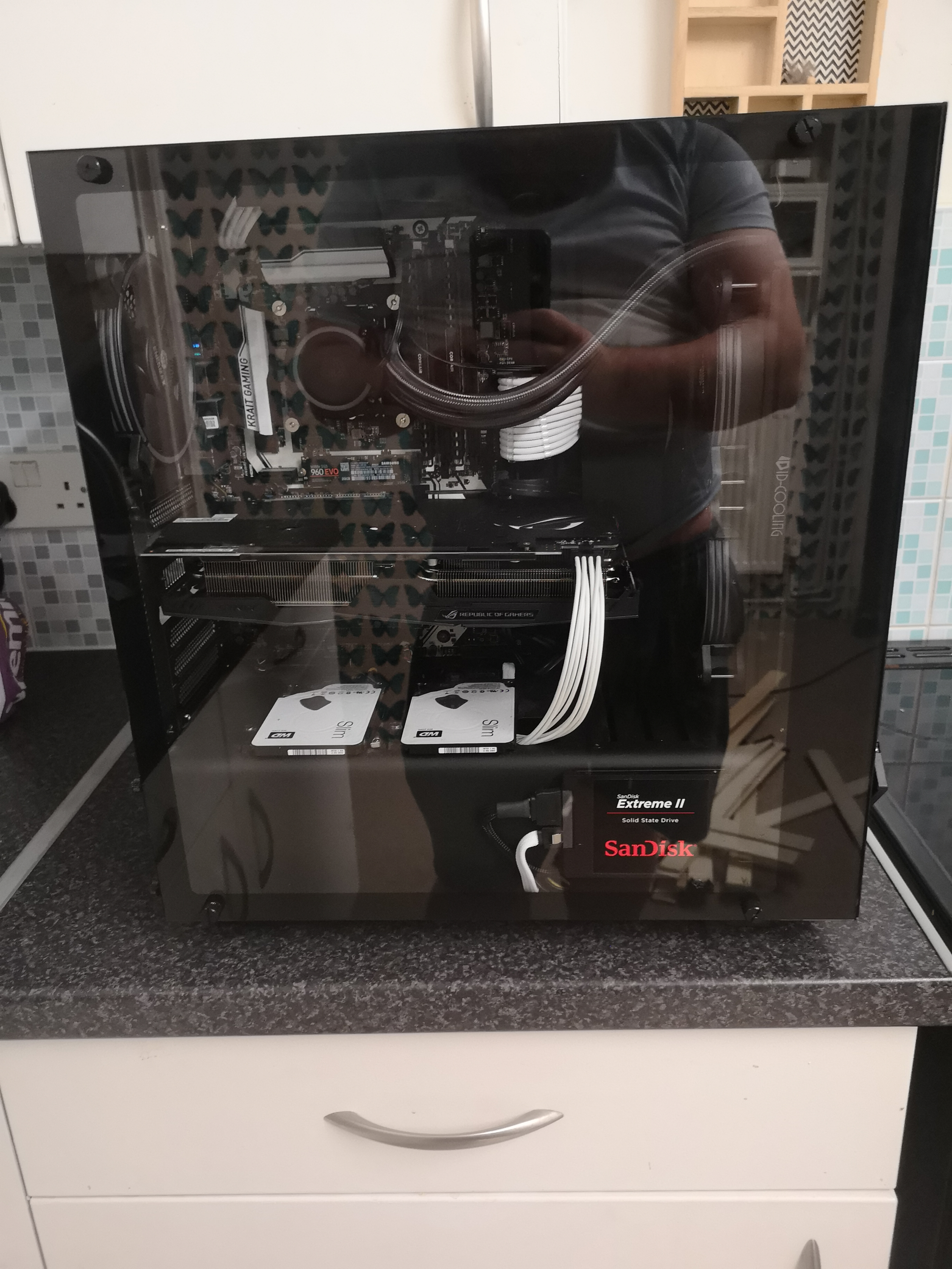

There a picture of my pc! (No reason for this picture other than to show you how beautiful my bulid is lol)
Another pointless picture ( just wanted to show how bad my cable management is behind closed doors) lmao

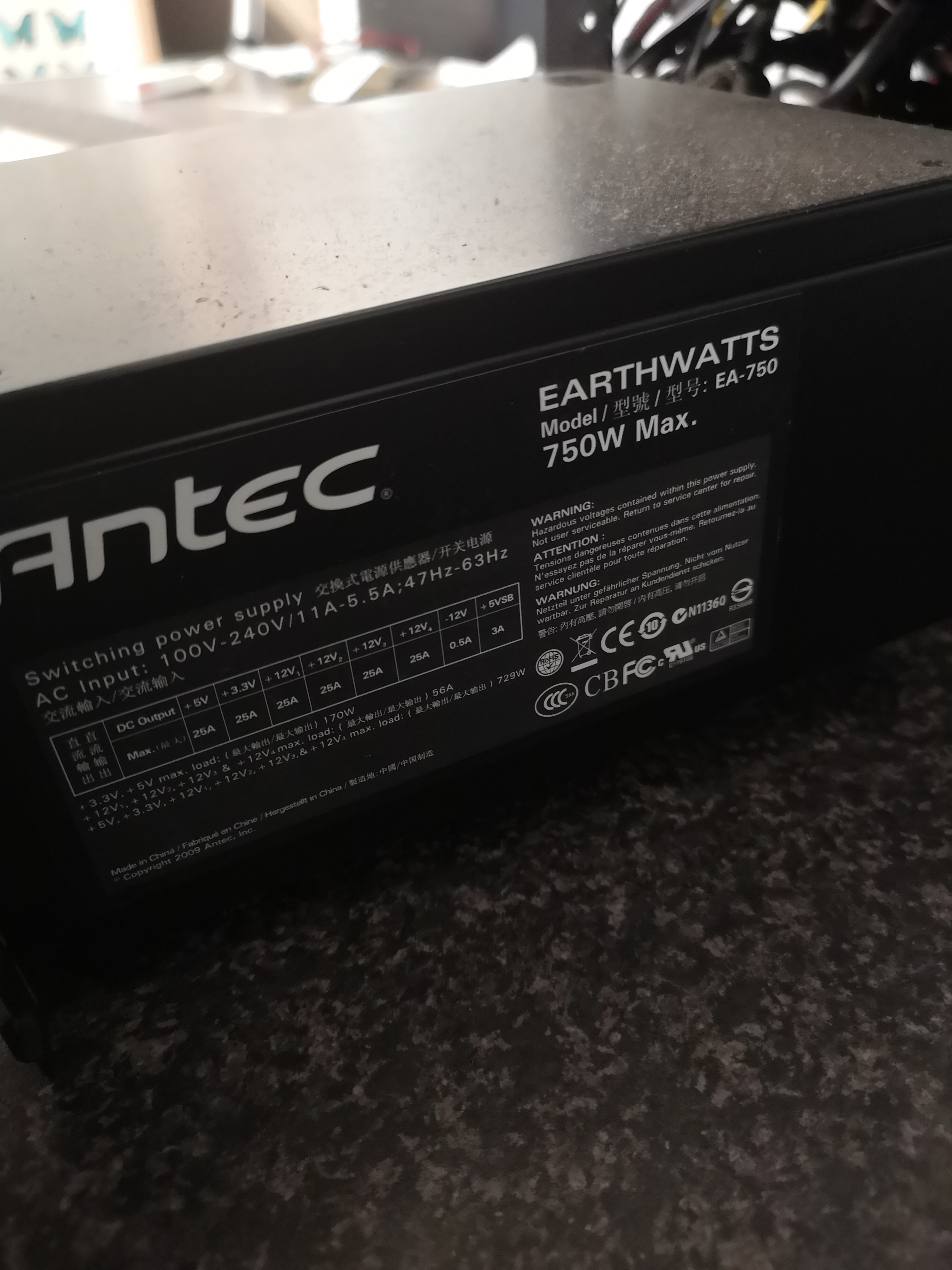

Picture 3 is I've the PSU I have.
Picture 4 is of the fan I have to fit in th PSU. Looks like the PSU has a 140mm fan and my spare is 120mm, dose it matter. I'm sure 120mm would be just as fine.
Any advice on this??
