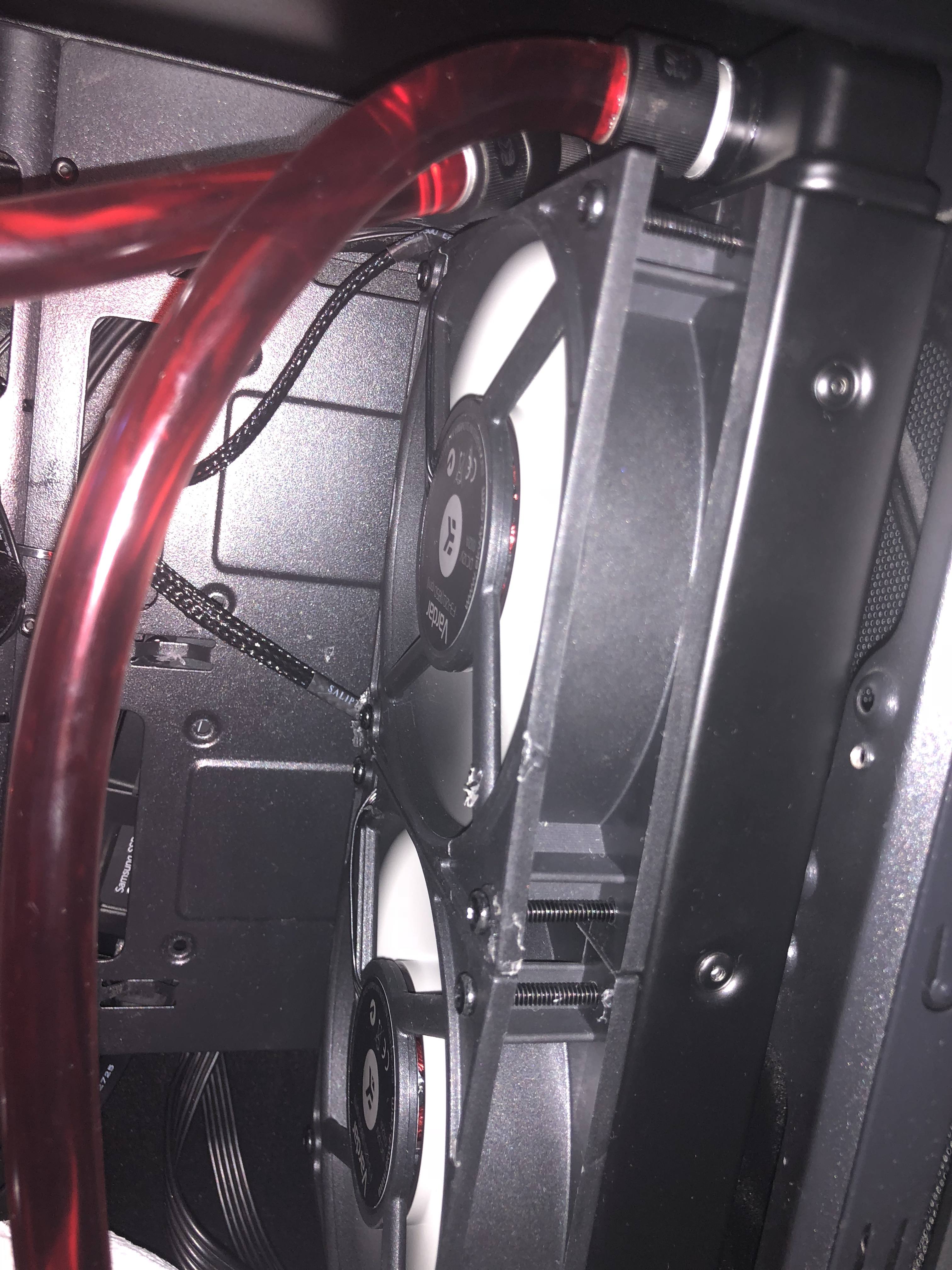

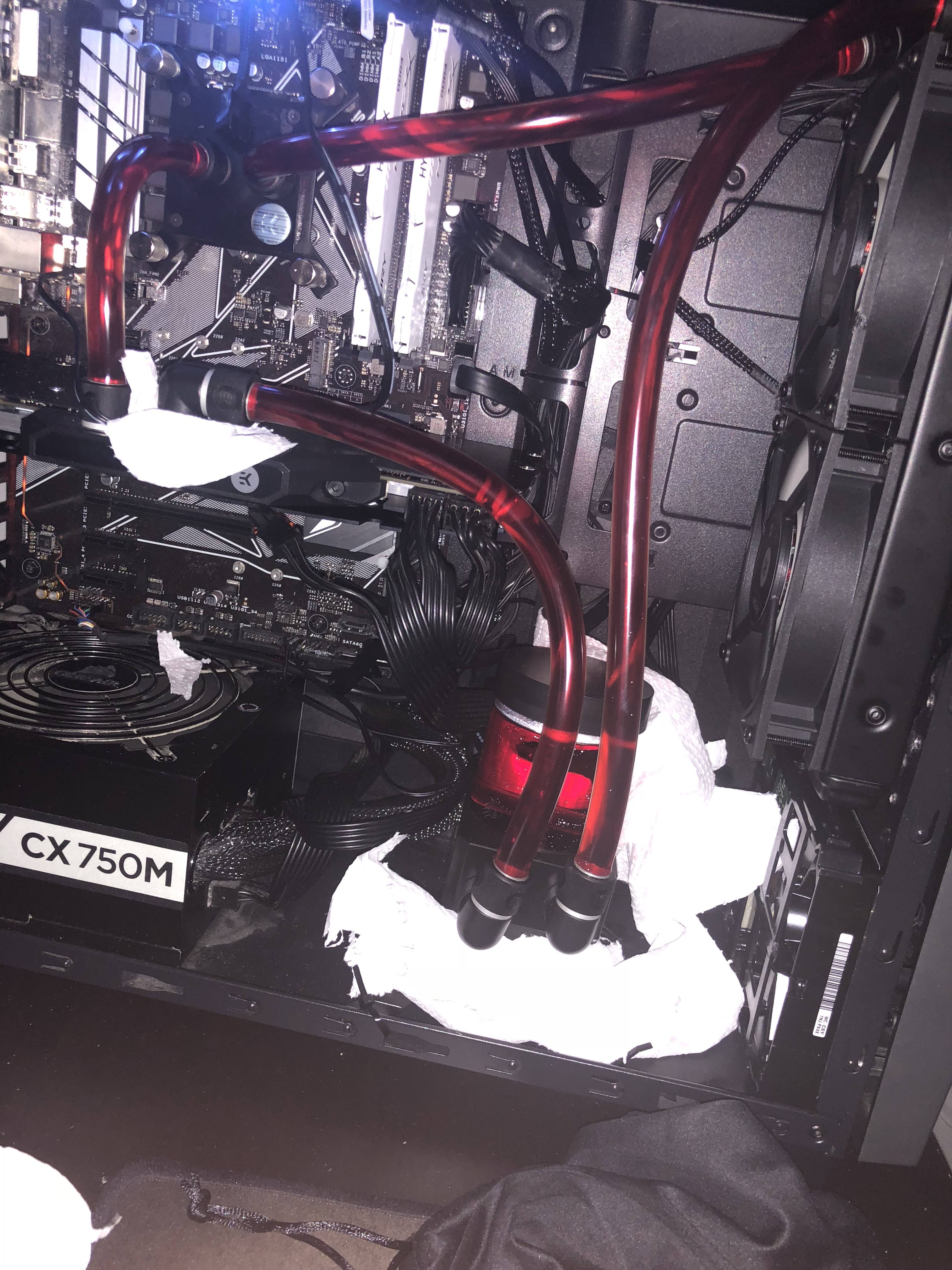

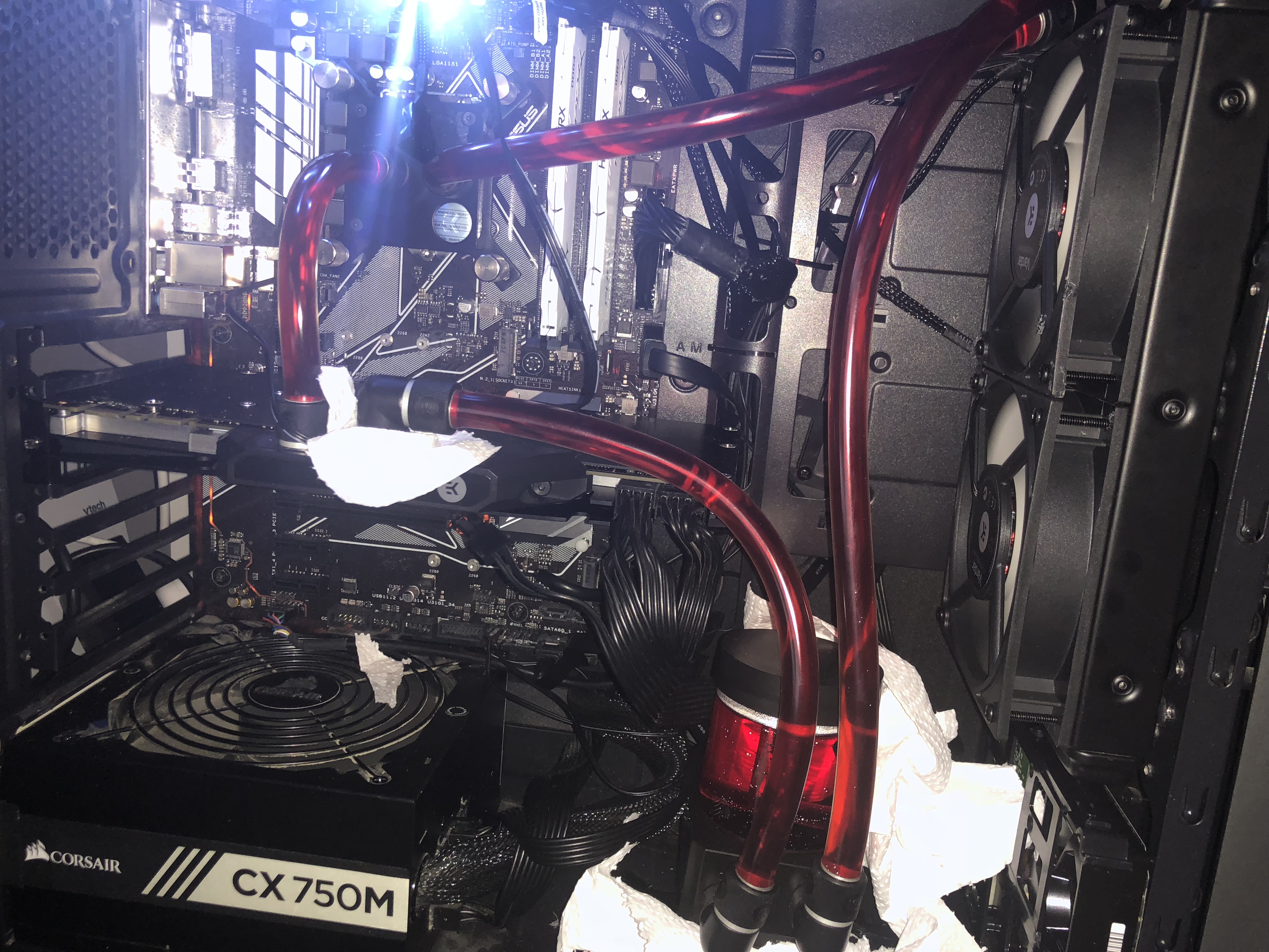

I took some photos , did I assemble the kit good? I relay afraid I didn’t something wronggg it took me 10 hours to assemble.

it means the rad is working, if the air were cool it'd be a problem
you're running a shared loop so that means the coolant has to go through the graphics card first, its temperature raises as it flows through the block and reaches the CPU block in that state, warm, that's why the CPU temp is high
as far as I can see you're using a single 240mm rad, kinda small for a 8700k + a graphics card

between the card and cpu? it might drop a few degrees but make sure it's thick and running in a push-pull config
the PSU is upside down you can tell by the amount of dust in the fan

@Adab5 I don't think anything's wrong. The 8700K is a toaster and the 1080 doesn't exactly run cool. On a single 240 rad that's about what I'd expect from that combo. I'd recommend adding another 240 rad to your system BUT be careful you're buying an ALUMINUM radiator - most rads are made of copper and you shouldn't mix metals in a loop

you are fine, as explained before it is because it is shared loop, adding more rads will help but I would still keep it a shared loop for maximum peformance.

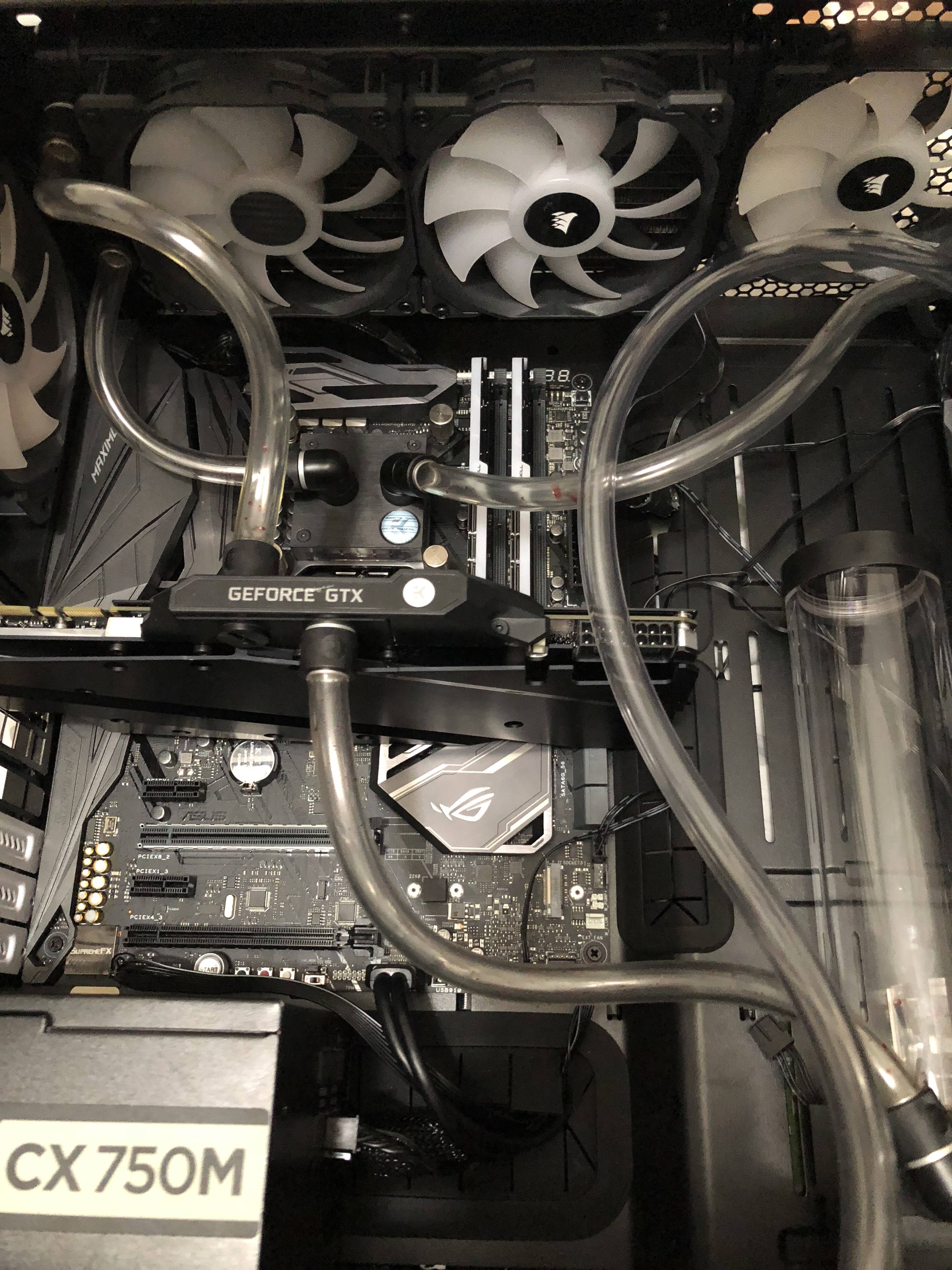

So.. I added another 240 rad now it’s 2-240 rads
temps
gpu went from 65C to a woping 47c under 5 hours of 100% loaf and oc to 2030/6100
cpu- still 1.34 still 4.8 and  74c in prime 95 small ftt test,
the cpu was 78 so it’s only 5c Lower, why am I not seeing any change on cpu ?????
I added a pic of how I did the loop,

You are aware, that Prime95 puts your system under torturous loads with AVX? Voltages will go up under those loads. A lot of BIOS give you the option for setting an offset for AVX loads. Some Prime95 versions are worse than others in regards to AVX loads. 73°C under Prime95 isn't bad though. On air that CPU would probably boil at over 90°C. Anything under 85 is considered as absolutely safe. The limit is at 105°C. Your CPU will throttle down at that point.
It is a bit würde though that temps didn't go down a little bit further. Did you try reseating the waterblock? Are you sure you used enough thermal compound when delivering? Are you sure you applied your OC correctly? Have you tried stock clocks and voltages? Have you tried a different stress test?

I tried re paste thermal and nothing changed,
I tried Aida 64 and the max is 67 (before the new rad it was 74) which is totally different, picture but still way less then I wanted the temps to go down :( any other idea?
can  a pc in a daily use of hardcore gaming and a lot of video editing can stress more then Aida 64 ? Or I can concern those temps for the real max
