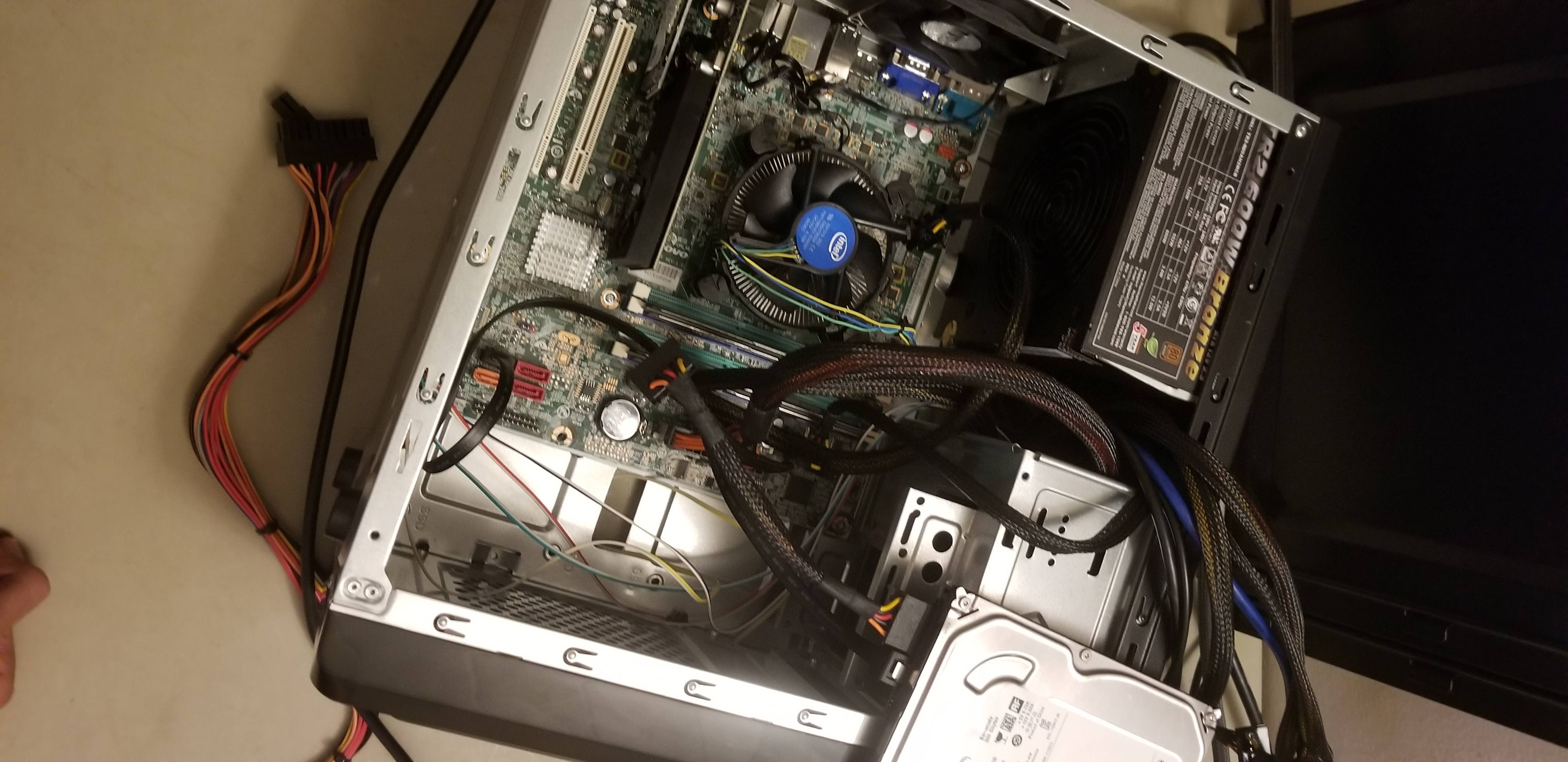

So I built my new computer and press the reset switch and it came on with 1 beep then turned off. After that I kept on pressing the reset switch because I thought it was the power so I thought something messed up. first of all I wasent pressing the power button so I started to mess with cmos and then I noticed I wasn't pressing the power button then I pressed it and it gave me 3 short beeps 3 long beeps and 1 more short beep.

1 hour ago, narrdarr said:
can't find the the correct match for the code, but can you pull all the ram out and try booting. then try different slot. lets see what beeps you get then
I tried this with 2 differnt ram sticks and trading it bewteen 2 and 4 and 1 and 2 slots and nothing happen

i had an issues awhile back. where the dimm was shifting just so slightly before locking in causing problems. make sure its square and push down evenly.
also remove all power before switching dimms and turning.
1. power down
2. remove battery
3. hold power button to drain all power of the motherboard.
4. remove dimm(s)
5. reinstall centered and with even force
6. add battery
7. plug in and turn on
