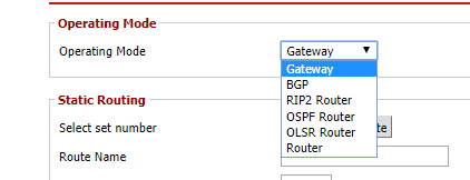

7 minutes ago, #Banana said:
Update: so far i have disabled dhcp authoritative in the GUI for the router.
Question: will any of theses operating modes turn the router into a bridge?image.png.fd80568e918b2526e28a58fdabb5d95b.png
So are you basically just wanting the Buffalo router to act as a switch?
If so, you'll basically want to set it as a normal router from that selection, ensure that it's connected to the network via the LAN ports, not the WAN port. Disable NAT and DHCP.
RIP2, OSPF and OLSR are all routing protocols and BGP is border gateway protocol.
If there's an access point mode anywhere in the settings, enable that. It will keep the LAN ports active and the WiFi but will disable NAT and DHCP.
Honestly though, if you want to connected some wired devices, get a switch. Messing around with multiple routers on a single subnet can be a bit of a pain sometimes.
https://linustechtips.com/topic/942998-dhcp-problems/#findComment-11491679
im moving in a month xD. I dont disagree with just getting another switch but it would be a waste of money as my next apartment will not be as complex as my current one. I currently have 2 switches routing ethernet in my apartment that was wired (im going to miss having a wired apartment).
