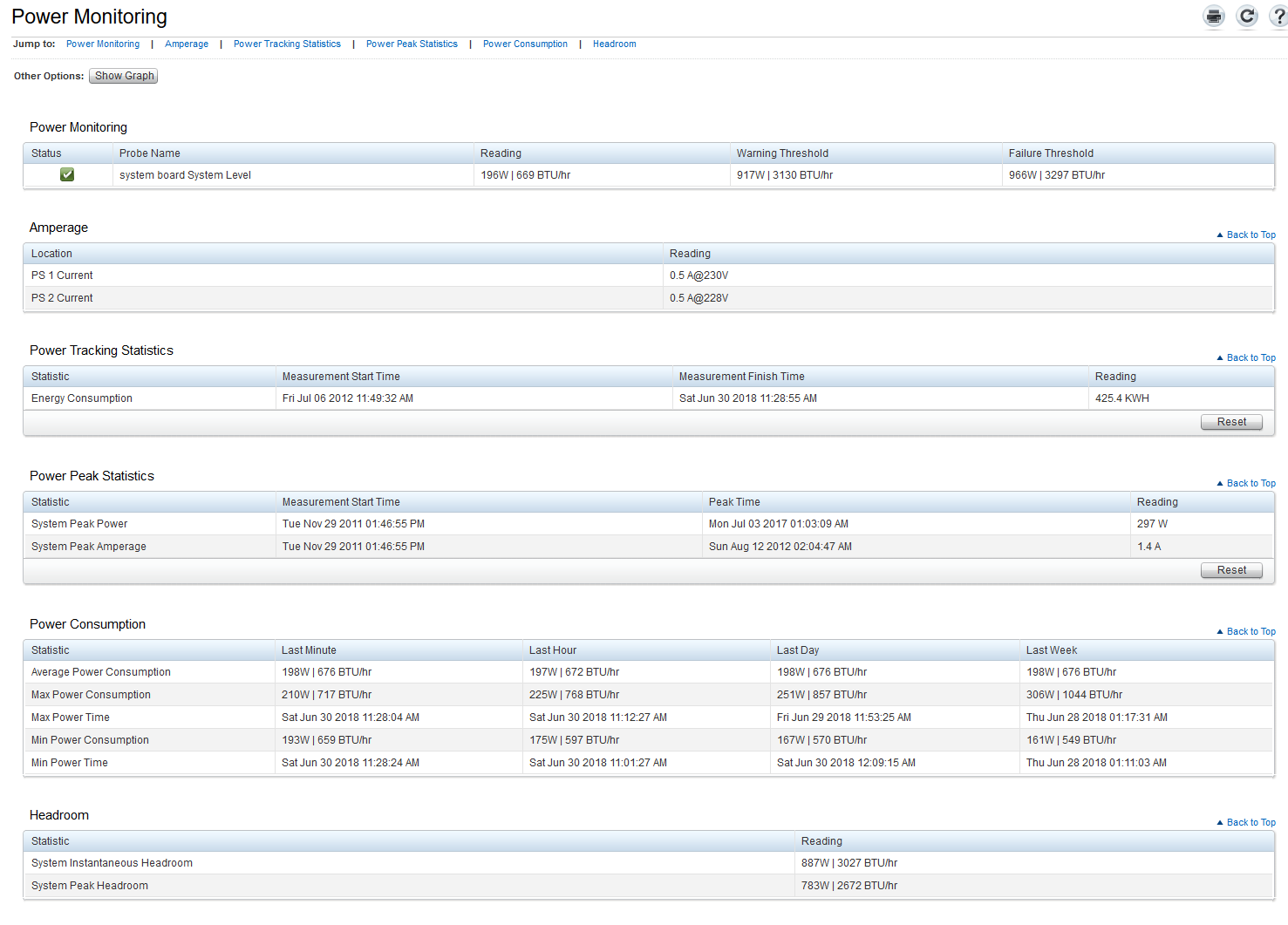

If you update drac to the latest version, it will give you the power usage of the r610 over a period of time in the power monitoring section;
If you are worried about using too much power, a power 'cap' can be specified preventing the unit using too much power.  This will sacrifice performance but it will keep bills reduced :)
Attached an example;
Which CPUs you got in that system?
It has a pair of X5650's with the power configuration set to OS Managed rather than Max Perf..
Please quote or tag me if you need a reply
Mines set to max perf in bios and ESXi, still surprised how much my systems draw with the L5630s in it. Figure the 6 HDDs, 2 SSD and RAID card are adding to it a bit, weird seeing a lower power Xeon system using the same as a max performance X Xeon system.
