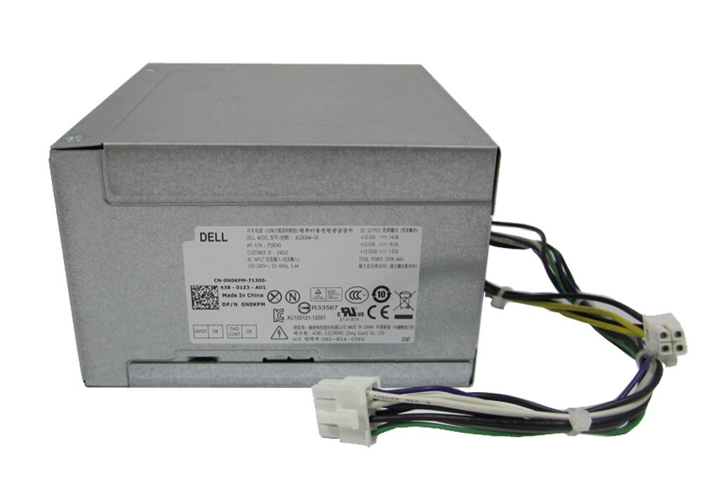

Hey so my power supply burn`t out and I need a new one I don`t want to spend a lot of money so I only have like $15 - $20 bucks to spend on one and I found this one on ebay and I was wondering if it will work to replace my old one.
Here`s a pic of the old one

I wouldn't. 1. I can't see on the pictures provided but either or both the Dell and hp psu may have proprietary connectors that may cause it to be incompatible with the motherboard. 2. Buying a used crappy psu is a recipe for disaster. Id save up and get a new psu that will last and won't die on you for a while.

Even if you get the correct connectors there is a pretty good chance that it won't fit into your case.
Also how do you know that the psu which burned up didn't take another component with it? I guess theres only one way to find out if you have no way to test the system.
edit: there is always the ability to run some kind of open air test bench set up if a standard psu won't fit.  Also I'd look for a company that recycles used pc components, maybe they have one that will fit

That looks like a Standart ATX PSU to me and plus I have rarely seen an 80+ PSU with proprietary connectors and size

I'm confused.  Dell PSU dies so you want to buy an HP one?!?!?
What's the end game here?
Tell us what kind of Dell you have so we can see if it's at least a standard PS2 size/mounting with a standard ATX 24-pin power connector.
Or take more pictures.
Otherwise....  NO WAY.
https://linustechtips.com/topic/892030-new-power-supply/#findComment-10998934
So a quick Google shows that the Delta DPS-290EB is a standard PS2 mount... but the power connectors don't look like standard ATX.
Now, if we google a Dell Optiplex 3020 motherboard, which is where you usually find said PSU, we see that the motherboard is in fact, not standard:

So I would suggest just throwing the whole thing out and building a new PC.
You think I'm joking, but this thing is going to end up being a can of worms.  New PSU.. then board dies.. .then new board... vicious cycle.  And you never really have the opportunity to upgrade because it's all proprietary Dell crap.
You haven't seen many Business Class computers lately, have you? ;)
Those usually have non standard PS/2 PSUs.
They still use the same PS/2 Casing but are +12V only, either with a +12V Standby rail like this unit or sometimes with a normal +5VSB rail.
That seems to be somewhat standard in this area...
You need to buy the exact type you had before since it's not a standard PSU. You're limited to compatible Dell part numbers.
https://www.ebay.com/itm/Genuine-Dell-290W-Power-Supply-0XFXKX-80-Plus-Gold-DPS-290EB-A/152733889902?epid=1666550718&hash=item238fa6356e:g:FcwAAOSwg0BZ2Tff
That's the only one on eBay at the moment.
