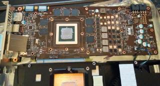

Hey! So I want to replace the stock cooler off my MSI GTX 980 OCV1 and I found an EVGA SC Gaming ACX 2.0 cooler on eBay for $40. I just wanted to make sure that if I get it and swap it onto my GPU, everything will work fine. It looks like it should fit since this is my MSI PCB:
and this is the EVGA PCB:
If I got the images right, both cards have the same PCB layout so the cooler should fit fine, right? My only other concern is that the MSI PCB is going to control the EVGA fans a little weird, could that be an issue that can be fixed with a custom fan curve or something? If there are any other potential issues, please tell me! Thanks!

That doesn't look like the exact same board to me. The design of the exhaust vents on the MSI card are straight up and down, not triangle patterned. Granted it probably won't matter since the mounting holes on video cards tend to be the same throughout the same GPU.
As far as the fan goes, they would both be using something PWM based so it wouldn't matter who made it or what controls it, it'll be the same.
Yeah, mine has vertical vents. This seems like a more correct photo:
MSI-GTX-980-4GD5-OCV1-GeForce-GTX-980-4G
Still looks like it'll fit though.
20 minutes ago, gawax said:
I think both PCBs are reference design so you shouldn't have a problem with that. For the temps just download MSI afterburner and adjust the fan curve in the settings, play a game and see how that works out.
19 minutes ago, APasz said:
As long as all the components that need cooling get it and the mounting holes line up, everything should be good.
nice. thanks!
https://linustechtips.com/topic/888037-replacing-gpu-cooler/#findComment-10958183
Reference boards. The rear vents won’t matter being an open air cooler.
They only added those for fancy fancy cards to make them look special.
