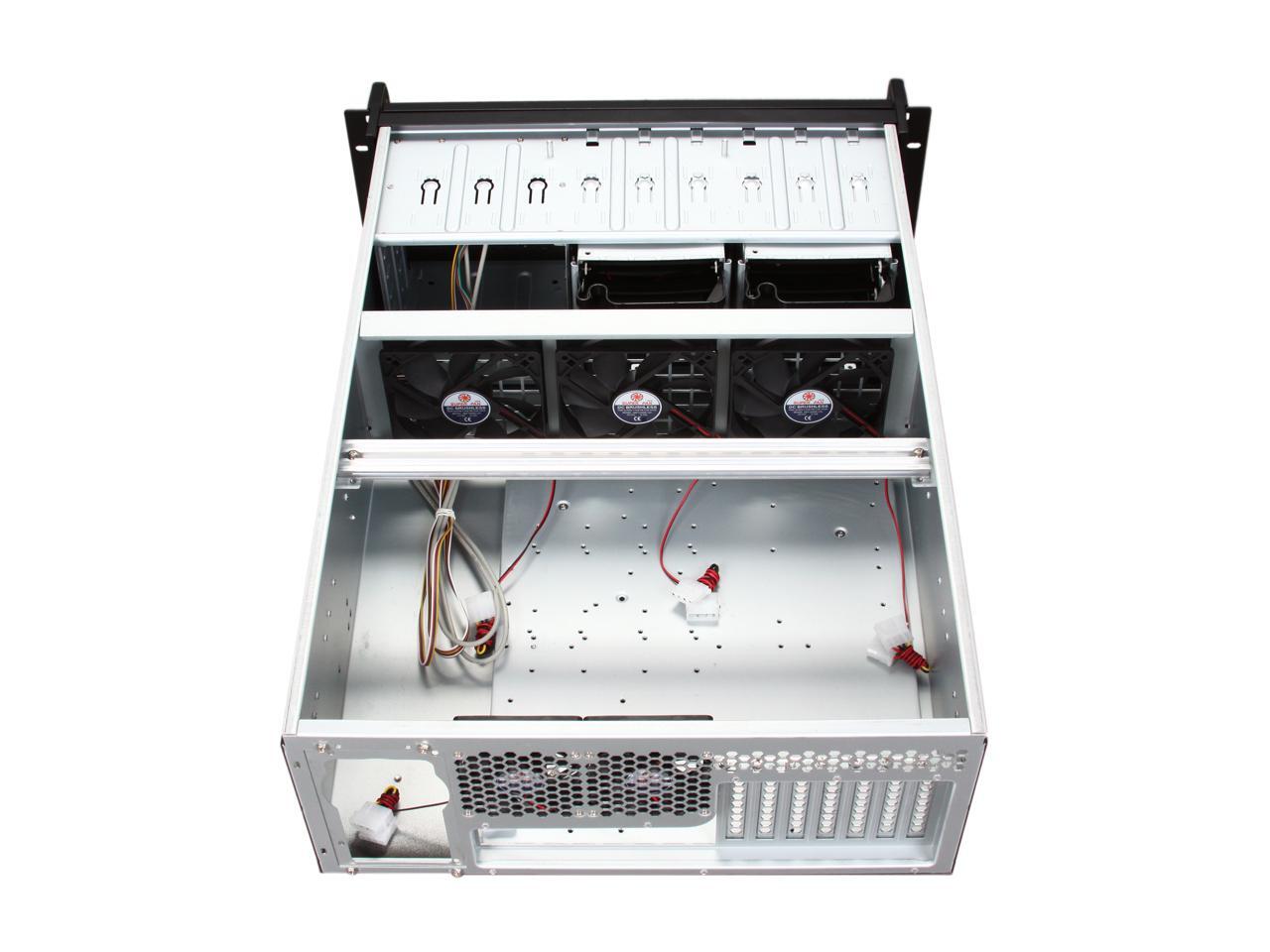

Im looking at getting the Rosewill RSV-L4000 and I seem to find mixed results on rad support. Can I mount a 360mm radiator? If I can without modding, will it have room for push pull? Also any recommendations on 80mm replacements for back fans, Noise not that concerning (My hearing is terrible and Im probably shoving in a closet)
Not without modding, hole alignment isnt there for what you'd need
Weird question then, with that hole alignment, would 3 120mm (for custom loop) rads work. (one per cpu then the 3rd support gpu)
Negative, good sir. Think about the RAD tube connections. Where would those go? Theres no space for them :/
