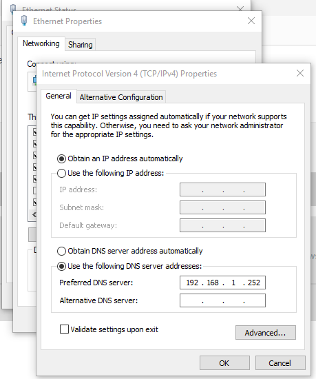

32 minutes ago, enocadrian13 said:
How I can setup the DNS Server?
DNS is already installed when you installed AD. Go the the client machine, under DNS servers enter the IP of the your DC.
Like this:
