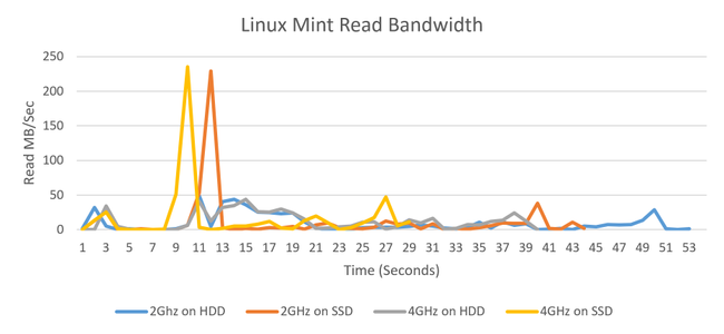

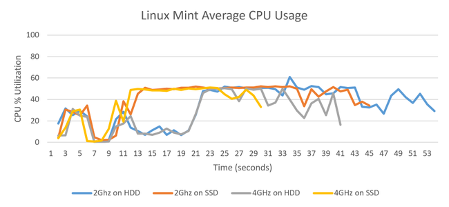

Well, that performance should be nearing NVMe territory (i.e., 2,000 MB/s with three times the IOPS, for high end models anyway), but it doesn't appreciably improve performance when it comes to loading stuff.
The thing with loading applications is that it isn't just "move stuff from RAM", it's "run stuff to make the application usable", which is dependent on the CPU. By moving to much faster storage, you've shifted the bottleneck back to the CPU. Take this for example, this is loading Linux Mint from after POST to a login prompt:
41af433a46598b0a2506abf2ca088cb0-650-80.
e434b7c124d5f21240f2896044489917-650-80.
Note this was captured loading it from a VM which only used half the cores available to the system, which is why CPU utilization appears to be capped at 50%
Also note that the 4GHz on HDD beats the 2GHz on SSD.
So IMO, going beyond SATA SSD performance is not worth it. Unless of course you have a use case that actually does scale with storage performance.
  Reveal hidden contents
