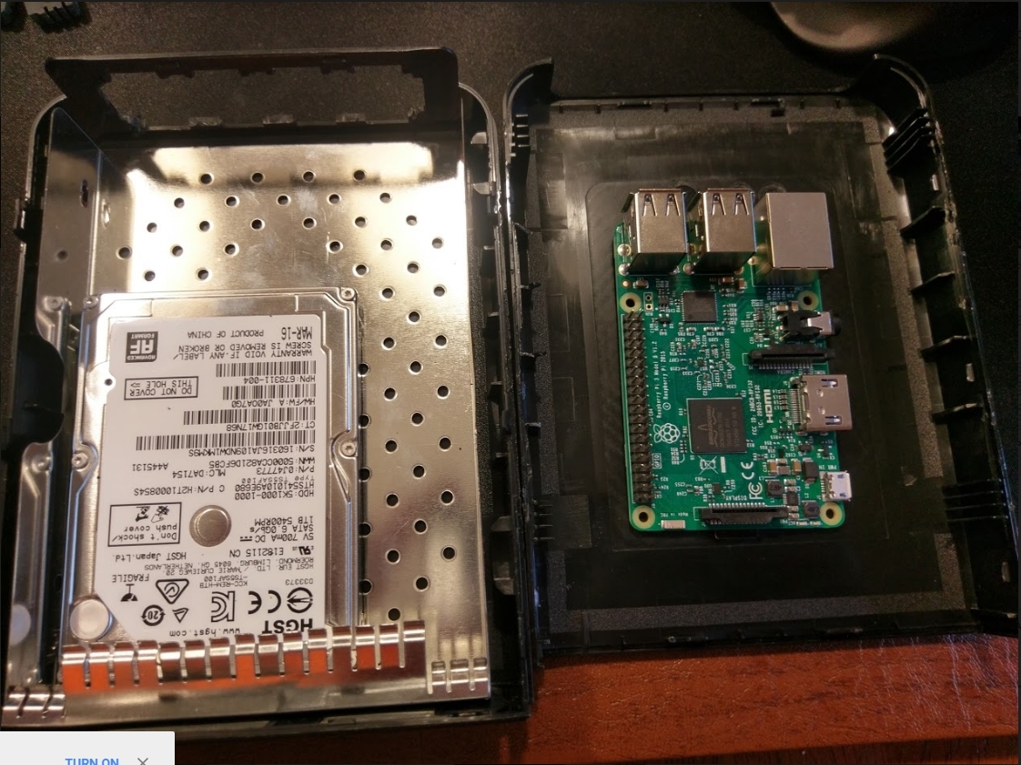

Here is my goals before I go into details about what I need help with:
1)Install webserver on Raspberry Pi 3 (done)
2)Turn Raspberry Pi into media server (done)
3)Turn Pi into NAS (done)
4)Keep everything contained in a GoFlex Desk enclosure (Will be going near router, which is near TV, so it will look nice.)
5)Would like to not spend a dime on this project ;)
____
____
Here is what I have so far:
1) Removed old 3.5" hard drive from GoFlex Desk. (Dead)
2) I have a spare 1TB 2.5" drive I want to use.
3)Opened the top of the GoFlex Desk enclosure(for Raspberry Pi connections - more below)
4)With the 2.5" drive, There is enough room in the enclosure for the Raspberry Pi,
    - My main dilemma is how to secure the Pi in the enclosure.
       a) Do I mount it right on top of the drive? Picture here
       b) Do I mount it to the opposite side? Picture here
    -Obviously, I need ideas as to what to use for standoffs/securing parts.
Thanks

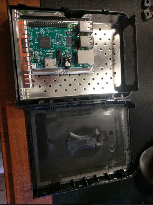

Labarr
https://linustechtips.com/topic/742260-need-mounting-ideas-for-hddpi/
I recently mounted a pi with tapped standoffs but I was able to do that into a metal enclosure.
For the plastics you might pop these in the pi then just use a #16 cement or super glue to attach these to the non drive side of the box.
https://www.bestbyte.net/computers-electronics/chassis/atx-motherboard-standoff-support-spacer-flat-bottom.html (I've got these with cases and I sure you can find them other places)
Rod
