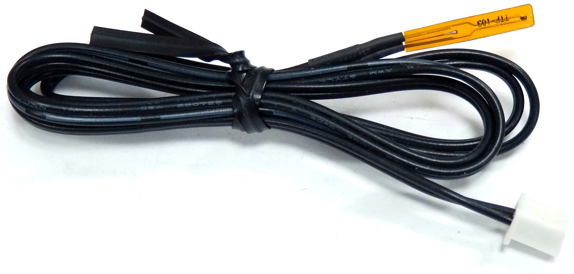

You will require either a T probe connection built into your motherboard so you can take readings or have an LCD type readout for temp probes. As for a solution that doesn't require you to dip into the loop, you can get a film thermistor and bond/tape that to a water channel in your rads I have something like that currently at the front intake rad to get approx water and intake temps.
Do you have any picture how do you have that installed?
You just put that orange thingy on raditator or between fins?

I don't have a photo of it but  I took a piece of soft foam and have it sandwiched between a fin and one of the water channels to get good contact.
From ebay you can buy water cooling thermometer kit just under $5. Comes with small LCD, molex power cable, a film thermistor.  For $10 you can get same kit that comes with thermoprobe that you can put between a hose connection with included barb fittings or you can change fittings to your liking (G1/4 threads)
