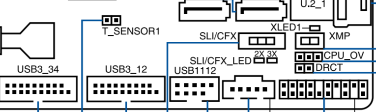

Thanks guys, the CLR_CMOS button worked and then the MemOK! worked fine aswell. Im in the bios right now, but I still can't figure out where I have to put my 2nd usb connector in for regular usb, not 3.0 usb

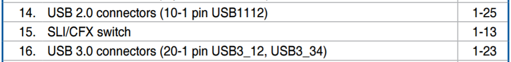

It looks like that board only has a single USB 2.0 header for front panel support, while the rest is 3.0. If you want to get that working, you'll need an adapter like this one (that one seems to use a stock image, but the listing is for a USB 3.0 female to USB 2.0 male, which is what you want).

Just now, Runefox said:
It looks like that board only has a single USB 2.0 header for front panel support, while the rest is 3.0. If you want to get that working, you'll need an adapter like this one (that one seems to use a stock image, but the listing is for a USB 3.0 female to USB 2.0 male, which is what you want.
Okay, i'm going to get that this weekend then.
Looks like they are between the  case umbilical pins and the USB-3 headers.

1 minute ago, Runefox said:
That looks like it might be the v1 of that board; The II only shows as having a single USB2 header:
That explains it then.
