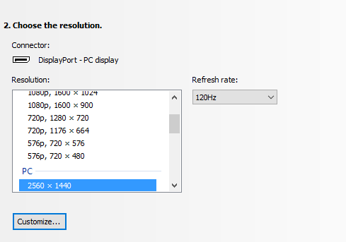

Just got the MG278 today from Amazon and 1440p 120hz works perfectly out of the box. I'm trying to enable 144hz and there's no option in the nVidia control panel or the Windows settings.
I'm using a GTX 760SC with the supplied Display Port cable. I also tried the Dual Link DVI and it's locked to a lower 60hz at 1440p.
Kinda stumped. I'm gonna play around with the monitor settings in the OSD and see if I can enable it somehow.
Anyone know how to get 144hz to show up as an option?

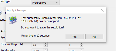

Also tried that. It says "Applied 2560x1440 @ 144hz successfully" but still shows 120hz. Vsync in Counter Strike still locks at 120 as well.

CRU? I tried the custom resolution button at the bottom and changed 120 to 144. I clicked OK and the screen went black as usual. It claimed that 144hz was applied successfully but everything appeared to still be 120hz.

I set a custom resolution after clicking Yes on this popup. Then the only sections are the standard HD ones and another section called "PC"

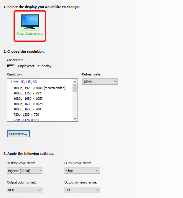

I should also note that this monitor shows up only as "Ancor Communications" rather than "Asus MG278Q"
My previous BenQ monitor had its name displayed.
https://linustechtips.com/topic/597672-enable-mg278-144hz/#findComment-7761582
Yea that's strange. The way to overclock monitor's with Nvidia GPU's is to create a custom resolution in NVCP and then it will appear under a custom resolutions section there, above every other section. Which should happen for you.

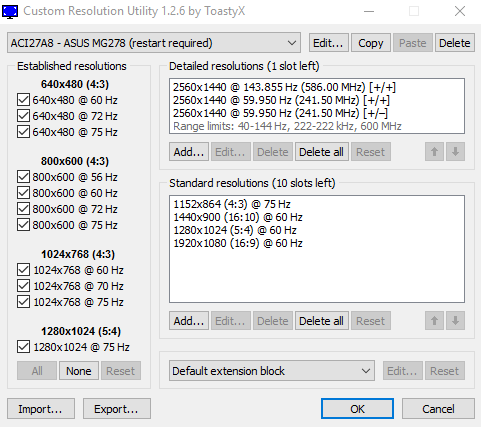

Here's the link to CRU which allows you to force any custom resolution if NVCP doesn't want to cooperate.
There's some guides out there that you can find which can help set it up, it's not too complicated.
http://www.monitortests.com/forum/thread-custom-resolution-utility-cru
If it's a software issue, CRU can fix it.

this is what I'm seeing. If I'm reading correctly my PC knows this monitor does 144hz but won't allow it to run that high. I think it has something to do with the pixel clock limit in that link someone posted earlier. It's a limitation of the GTX 760.
The 1080 will be out soon I can live with 120hz for now.

Most ASUS monitors show up as Ancor Communications. Every monitor stores information about itself, including the name of the manufacturer and name of the model. The NVIDIA control panel reads this information, and displays the name of the monitor as "manufacturer name" + "model number", so things will show up for example like "Dell U2414H".
However, in most ASUS monitors, the "manufacturer" line is filled in with the name of a company involved in the manufacturing (I'm assuming they provide the display controller or something related, but I'm not sure) rather than the name of ASUS itself, so in the NVIDIA control panel it would show up as "Ancor Communications, Inc. [display model number]". Since that's really long, it's truncated to "Ancor Communic..." in most places in the NVCP.
For example, this is what my configuration looks like at the moment, with an ASUS PA248Q on the far right:
But, if I look in the "Set up multiple displays" section, the full name is displayed there, and you can see the display model number with nothing amiss.
