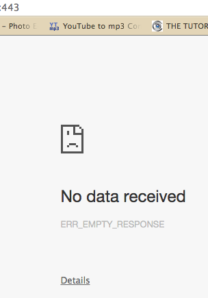

How does it know that port 443 is that exact type model of router? I know it is that router because i have seen it with my own eyes. But when i try to connect from port 443, i see this:
how does it possibly know?
since it is blocking me

all I see here is a router not having an HTTPS web interface...
No i am port scanning an IP
and i see that the router shows its config interface
how the fuck is that possible if i cant see it with connection from my browser
it doesnt let me connect from browser but
here
I nmap -sV a public IP and it showed me this
port 80 (normally)
port 443 which for some reason showed me what router was behind the firewall
port 3389-90 is RDC
HOW DID nmap FIND OUT WHAT ROUTER FIRMWARE THE IP HAD?
here
port 80 (normally)
port 3389-90 is RDC
I don't see where it says what firmware revision the router is.  All sonicwall routers have sonicwall firewalls AFAIK; nmap probably picked up on MDNS / NetBIOS
EDIT: It could also be noting what services are being forwarded through those ports (explaining Squid proxy on port 80 and the firewall forwarding through 443
How is this network set up?
i have no idea
I cant connect to it remotely
If it helps this is a school network
what is squid proxy?
if the firewall is ported throgh 443, then can i connect to the firewall somehow?
On a sidenote i have never experienced this picking up on my arris router at my home, but this may be different since i portscan with -Pn on my home due to it blocking ping, but this network does not block pings

i have no idea
They gave me limited information, like how a hacker is given limited information
They wanted to see what i could access and gather remotely
EDIT:
AFAIK squid proxy is a type of web page, like apache?
squid is for website caching, its a proxy after all

scan LAN and look for all connected devices.   See if you can locate the firewall by DNS/mDNS/NetBIOS and then see if you can use it's IP to access the remote console.  You could try hydra (or similar) to brute force the admin auth for the firewall or use some sort of packet analyzer to hijack an admin session
remotely was the goal.
Not exactly LAN is what i am aiming for.
For example if a hacker wants to attack remotely
yeah I bet their firewall blocks all uninitiated HTTP sessions unless they host some sort of server on that network.
why do you need to know this >.>
My school asked me to test their network
