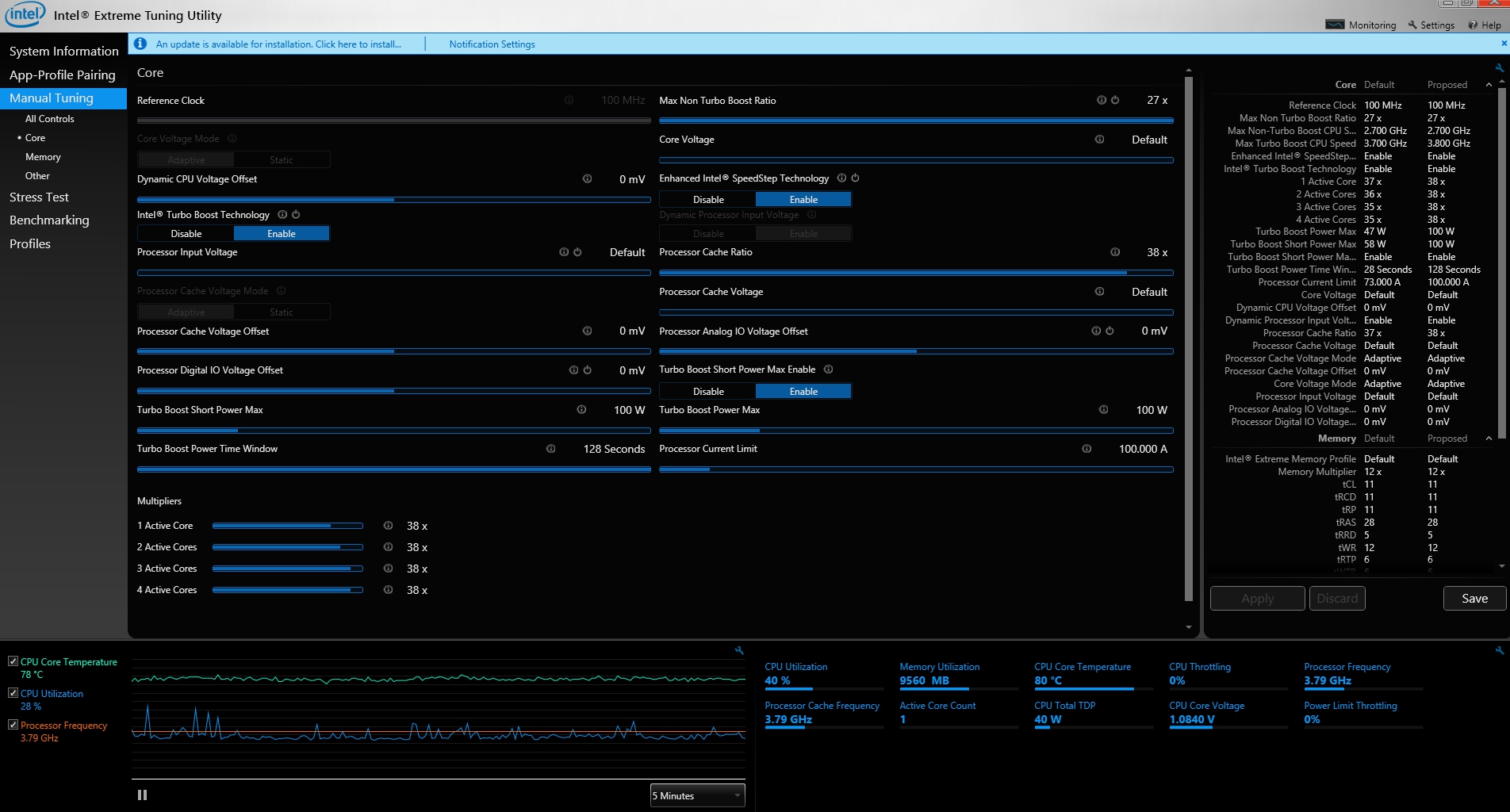

Maybe it's because I used Intel XTU back in the day and it had adaptive and static. Here, look under the reference clock at the top left. It's locked because core voltage is on default, but if I manually adjust the slider I get to pick between static and adaptive. Also, it's an old pic, so ignore the temps and whatever. I don't have XTU installed right now (I think).
Leave it to Intel to add another synonym for voltage settings. I've never used software to OC, figured I would only mention the tried and true BIOS terms. XTU keeps getting recommended to me for quick settings tweaks, maybe I'll give it a try one of these days (I only use it for benching and stress testing).
