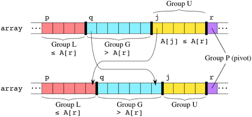

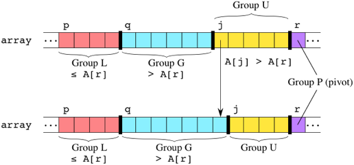

We divide our array into 4 groups :
  1. the elements in the array[p..q-1] are elements known to be less or equal than the pivot.
  2. elements in the array[q..j] are elements known to be bigger than the pivot. j will be a new variable.
  3. elements in the array [j..r-1] are elements which we haven't compared to the pivot yet.
  4. at array[r] we have our pivot
Initially, both q and j are equal to p, since we do not have any elements known to be bigger nor smaller than the pivot, since we haven't compared anything yet.
If you think about it another way,our j variable will be used for scanning through the entire array. At each step, it increments. If the value at array[j] is bigger than the pivot, then nothing else happens. If it's smaller or equal, then it also increments q.
partition_greater.png- first case, with a number bigger than the pivot
partition_less_equal.png-second case, a number smaller than the pivot
Once we get through the entire array, we swap array[r] with array[q], also while returning q.

  • If array[j] > array[r], just increment j.
  • If array[j] <= array[r], swap array[j] with array[q], increment q, and increment j.
  • Once all elements in array[p..r-1] have been compared with array[r],swap array[r] with array[q], and return q.

void quicksort(int *ar, int p , int r){    if(p<r){        int q = partition(ar, p , r);        quicksort(ar,p,q-1);        quicksort(ar,q+1,r);    }}
int partition(int* ar, int p , int r){    int q = p;    for(int j = p; j < r; j++)    if(*(ar+j) <= *(ar+r)){        swap(ar,j,q);        q++;    }    swap(ar,r,q);    return q;}
