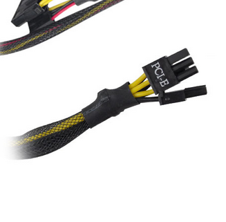

So look for a thing that looks like an 8 pin PCI-e that has a little thing with two on it that splits off.

dc7f4035fd7cd3a47f8d36511141023e.pnglook for this connector. It functions as a 8 pin PCI-E cable and a 6 pin PCI-E cable (not at the same time though) It is called a 6 + 2 connector.
