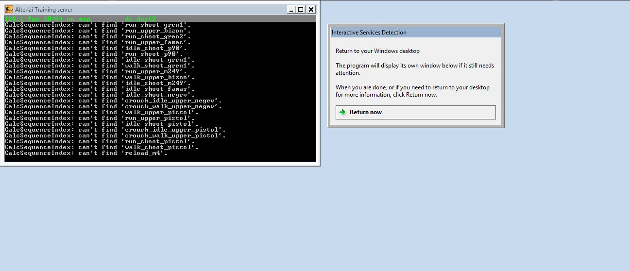

I'm building a Web application for personal use to administer my CSGO server remotely.
So far i've got it working. However there's a small problem.
Here's how it works:
1. The user logs into the web app.
2. The user clicks an operation for instance "Start Server".
3. The php script will launch the following function: exec("cmd /c $dir" . "start.bat");
The start.bat file contains the following: start C:\Users\jeroen\Desktop\srcds.lnk
(That's a link to the srcds software with proper launch options included).
4. The server executes the command and it works.
Here's the issue. Only when the script is ran by the php function, it'll run the server in session 0 isolation.
This is what it looks like:
However, when the .bat file is run manually, it opens the server in a normal cmd window.
Here's what i need to know
1. What's causing the php function to open the cmd shell in session 0 isolation? And how can i prevent it from doing so?
2. Is there a better/more efficient way to obtain the same result?

Since exec doesn't return input you should try to use system() and then echo the output it gives you to debug.
I don't actually need output in my browser. Maybe I should have clarified that more.
When i mstsc into my server i want to be able to see the cmd shell. So i can see what's going on.

Wait are you trying to execute a batch file from php and get the visual terminal to open or what? If so you're not going to really be able to do that with a system call.
i want to die
Yes I'm trying to do that. And is there a suitable way with for instance AJAX or something to get live output in the browser instead?
