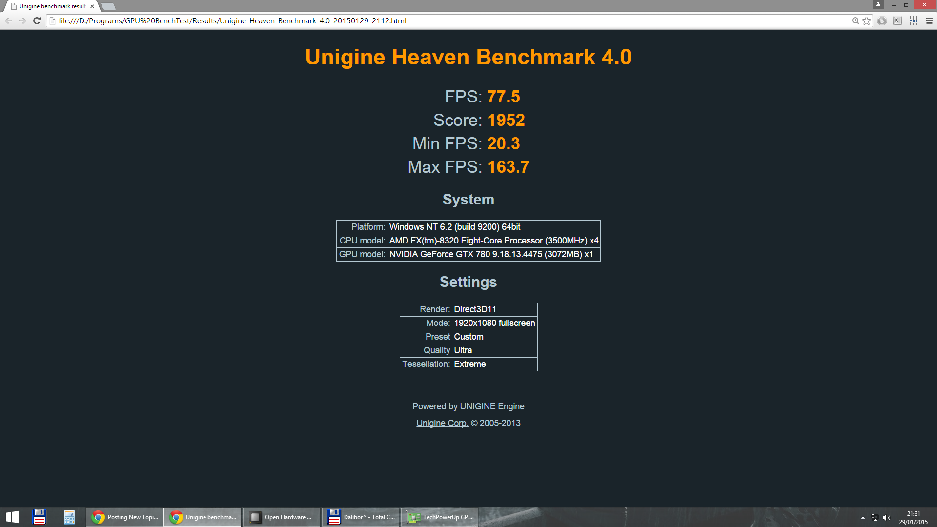

Hi LinusTechTips forum! :D
I just currently overlocked my PNY Gtx 780.
                                  GPU Clock               Memory Clock               Boost
            Base Clocks   863MHz                  1502MHz                       902MHz
Overclocked Clocks   1000MHz                1639MHz                       1039Mhz
                                          Temps; 43-44C top ( Watercooled )
Unigine Heaven Benchmark http://nemesisup.cz/files/public/780gtxoverclock.png( Opinions? )
So Im wondering if I do overclock my CPU AMD FX 8320 which should be easy to get 4,2GHz to I get more FPS? if yes why? ... I kinda dont understand it how can CPU give me more FPS when CPU is CPU and GPU is GPU :D ( Newbie )
I know I could just try and see what happens but I mostly want to know how does it work?
