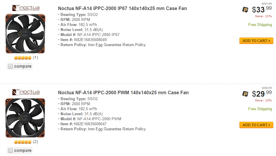

http://www.newegg.com/Product/Product.aspx?Item=N82E16835608047&cm_re=Noctua-_-35-608-047-_-Product Im assuming this is what I'll need?
PEWDIEPIE DONT CROSS THAT BRIDGE
https://linustechtips.com/topic/249666-kraken-x61-advice/#findComment-3423985
Yes
