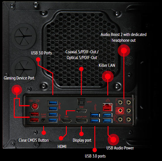

Hello,
Your best bet would be to clear CMOS, basically a restore to factory settings button which will completely remove any overclocking. Have you machine turned off and there is a button at the back on the Motherboard I/O, hold it down for 5 seconds and then turn your machine on and you will be asked to run setup by pressing F1; just follow the on screen instructions. This image shows how:
If this does not clear CMOS for whatever reason please post here and I will show an alternate way that requires opening up your computer case.

I prefer cracking it open myself.. It usually works because you know what's going on.
Same here, but pressing a button at the back of your motherboard is simplier and easier to explain  :)

Unless the button is broken. But I see the use of it. I can just never get to that side of my pc without doing parkour.. :P

there's no led indicator on my motherboard
this is my motherboard
The manual I was reading had an LED indicator, I was linked to the wrong board by the MSI website. I will post back once I have read the correct manual.
