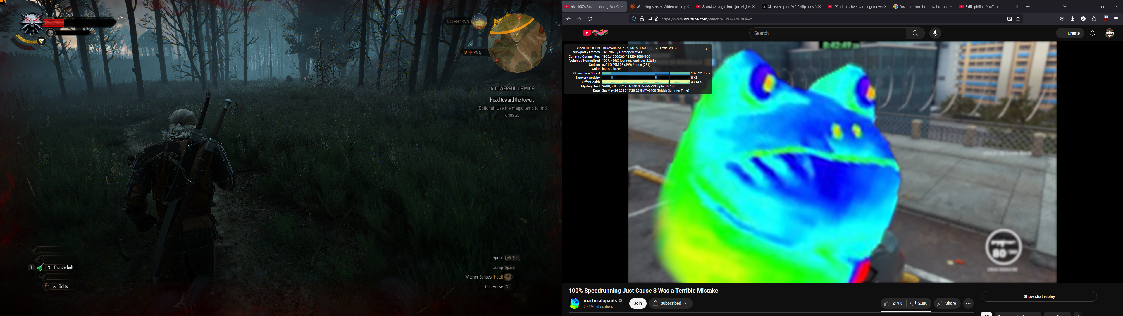

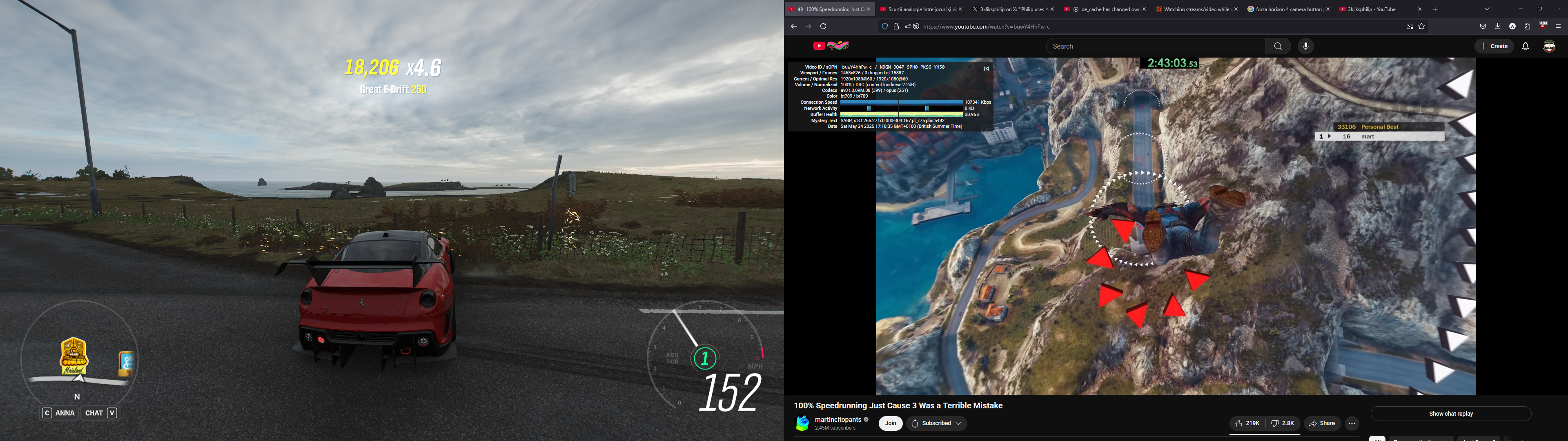

Nope. Not on my system at least. I booted up forza horizon 4, high-ultra settings, whatever the game defaulted to pretty much. Played a little and got 0 dropped frames.
For something even more intensive I've also booted up Witcher 3 and put it on Ultra preset. Not the greatest performance and my GPU fans were very loud, but no dropped frames still. Also main monitor is 165hz 1080p 2nd is 60hz 1080p.
