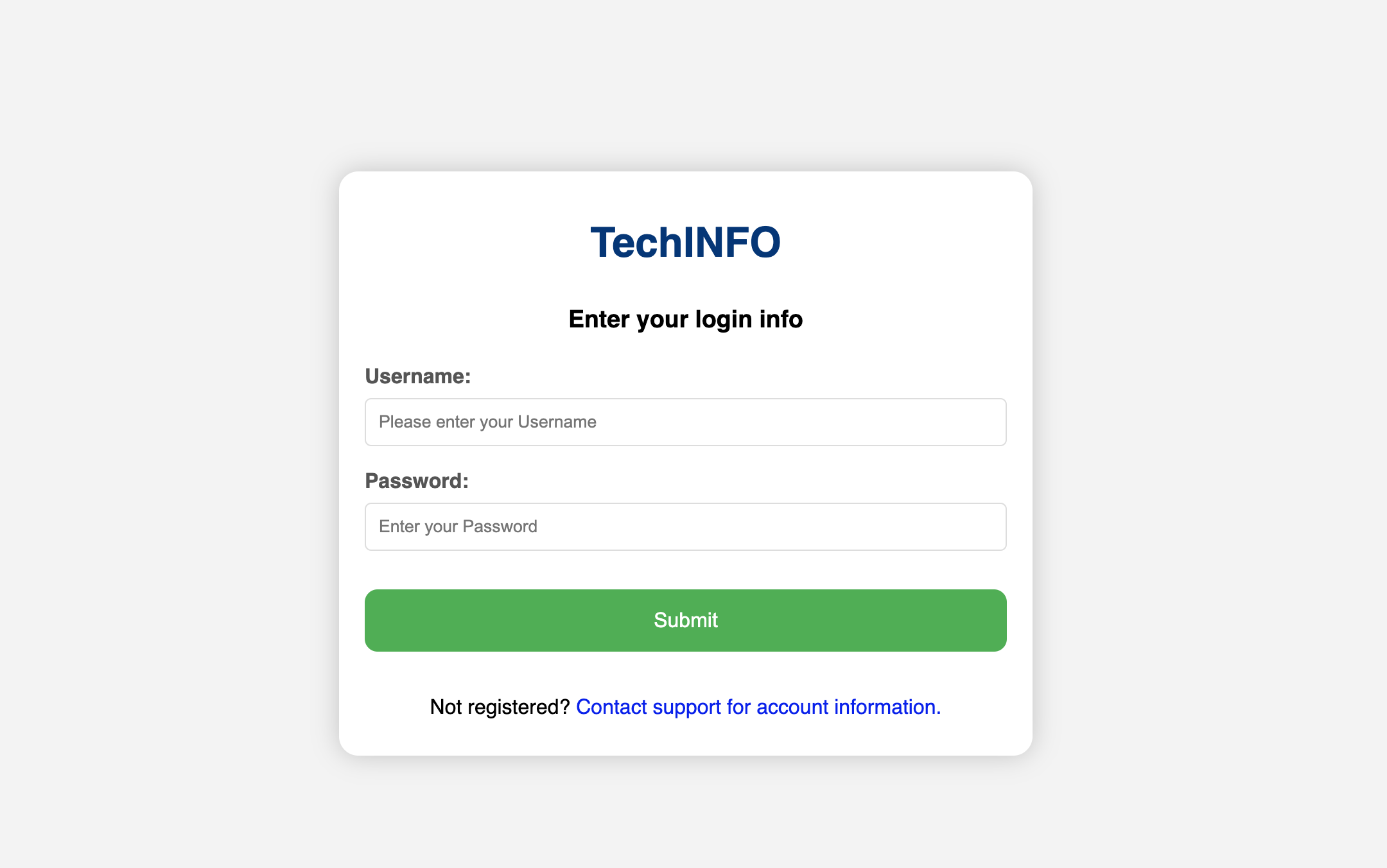

Login Form Using HTML Continuation <html>
