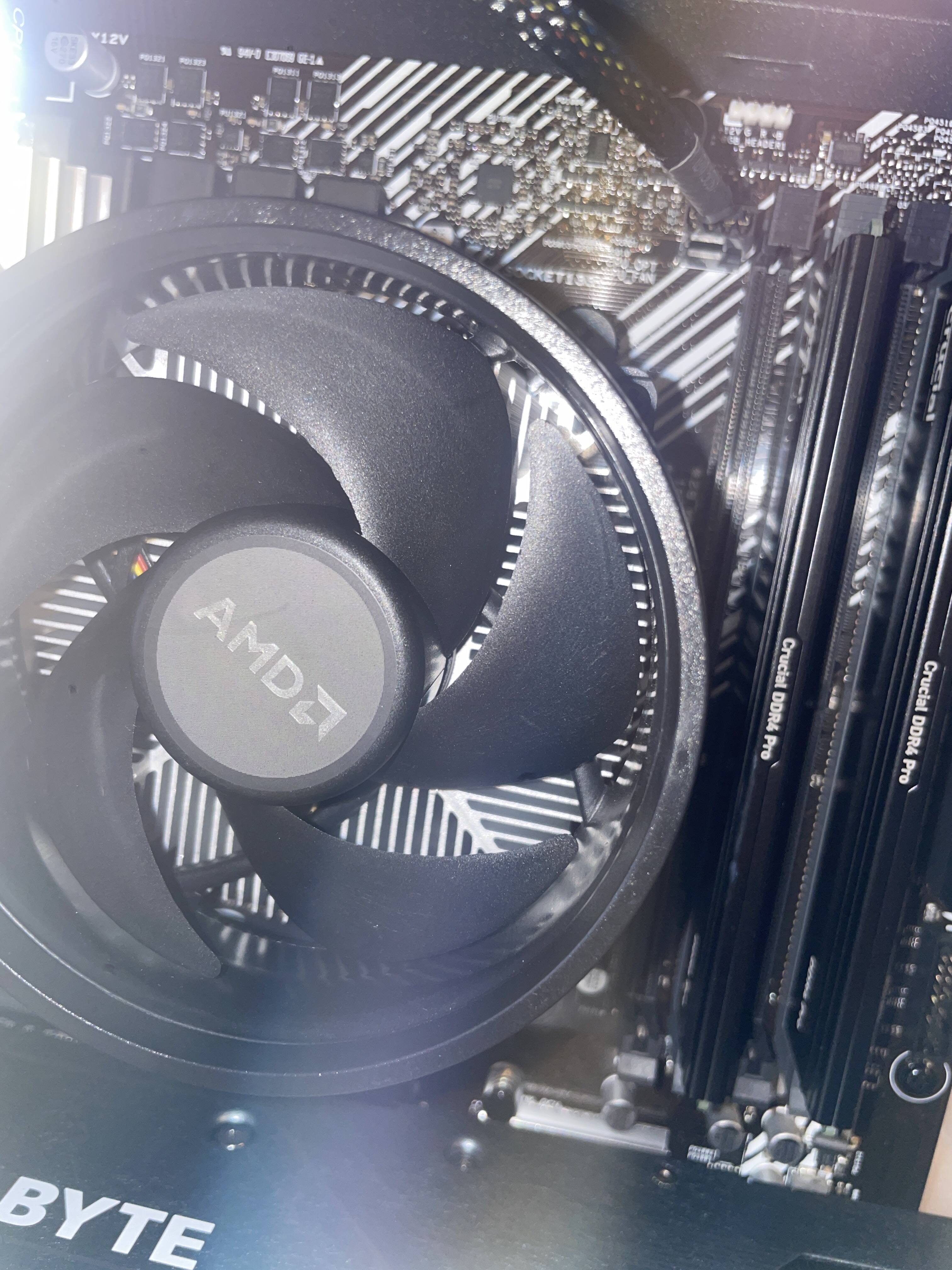

I just built the PC few days ago.
i have a termaltake view 170 case and I used the fans that comes with the case
(2 intake, 1 exhaust)
I installed all the screws very tightly and I think Amd stock cooler doesn’t come with plastic peels

This should be good, but do double check your GPU isn't also wildly overheating
50deg idle says to me there is a bad mount on the cooler.
I think you're correct that there isn't a film on the cooler. Instead there is a thicker plastic cup that basically doesn't allow you to install the cooler without removal.
Can you remove the cooler and take a pic of the paste spread?

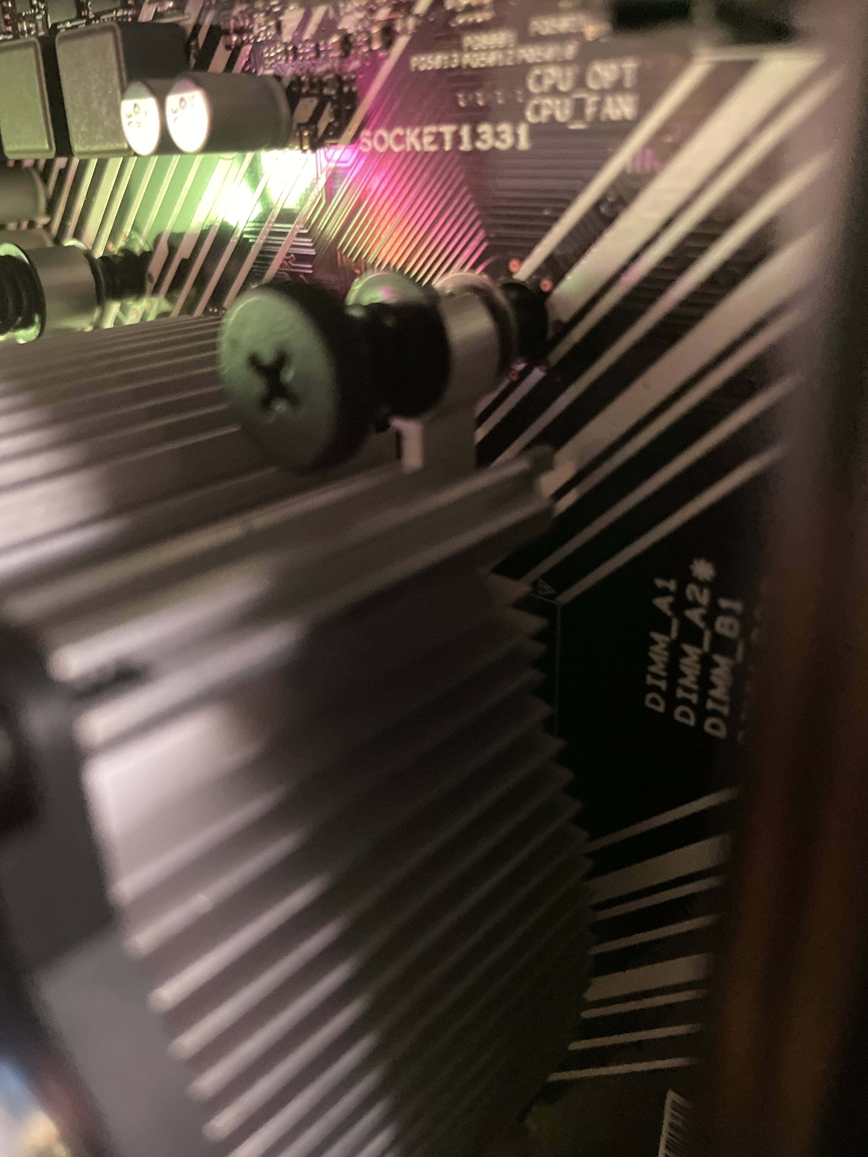

Things to check:
-is the cable of the cooler connected to CPU_FAN head
-if you used the preapplied thermal paste (which is fine), was it a nice and plane, did you touch it and maybe accidentally remove some?
-did you screw down the cooler screws completely (at one point they stop clicking and you can't screw them down further, don't force it)
-check the fan rpm in idle and while gaming
https://linustechtips.com/topic/1605987-5700-overheating/#findComment-16688091
