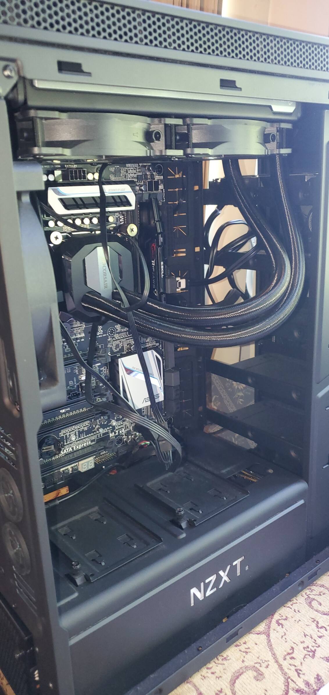

Bought a boot looping old build for $150: 980ti, ASUS X99-A, Xeon of some kind
Some pretty good parts for $150,
ASUS X99-A, idk why it has a server mb considering but hey
Xeon something idk yet
EVGA 750w psu
Corsair AIO
16gb 3200 ddr4 c-16
rando ssd and hardrive
ballin sound dampened nzxt case
check out the video to see it turn on, all fans spin for 2 sec, and shut off over and over
i did the pin test on the psu to test if it was that, tried booting with ram in the right spots (came to me with it in wrong), 1 stick, 0 sticks, no gpu
rn im just with cpu and mb power connected and same boot looping
i tried for a bios flashback (somehow it can do it even if the pc is off but power is on) and still the same, maybe i did the bios flashback wrong idk
really need some help to figure out the issue, and for as cheap as possible

send vid of the mobo turning on and bootlooping just to check the postcodes (below last x16 pcie slot)

its 00 over and over, and video is linked below the image

above sorry i didnt see the old one didnt embed
