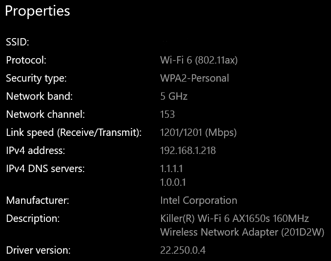

On Windows, right-click the Start/Windows button and select Device Manager. Look under 'Network adapters'.
You can also click Start/Windows and search for wifi settings. In the window that appears, click on your network's SSID and scroll down. You should see your adapter's model and link speed details like this...
