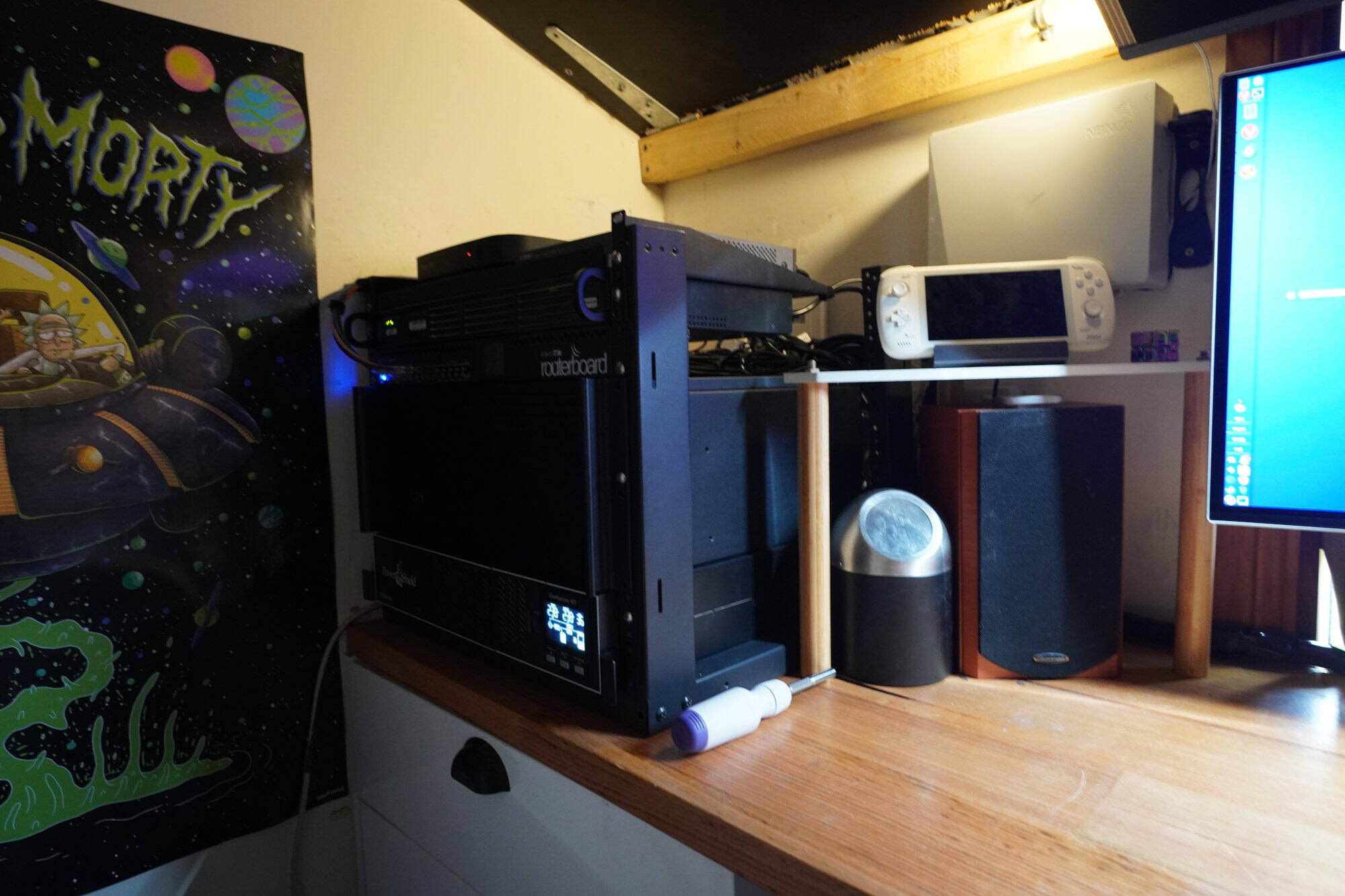

The Plan
This build has been designed with a network rack in mind, all my IT equipment
needs to fit inside the rack including my main workstation, server, cable tv,
amplifier, usb/network/power cords and UPS. I chose the Samson SRK8 8-Unit
Universal Rack for its low depth, as this rack is going on a 600mm table. I
purchased this from an audio equipment store. The floorplan space is quite small
(about 1.6m x 2.6m), comprising of a walkway, office desk and wardrobe,
originally just an office space but I’ve converted it to a bedroom with a murphy
bed above the desk. With both an exterior and interior door.

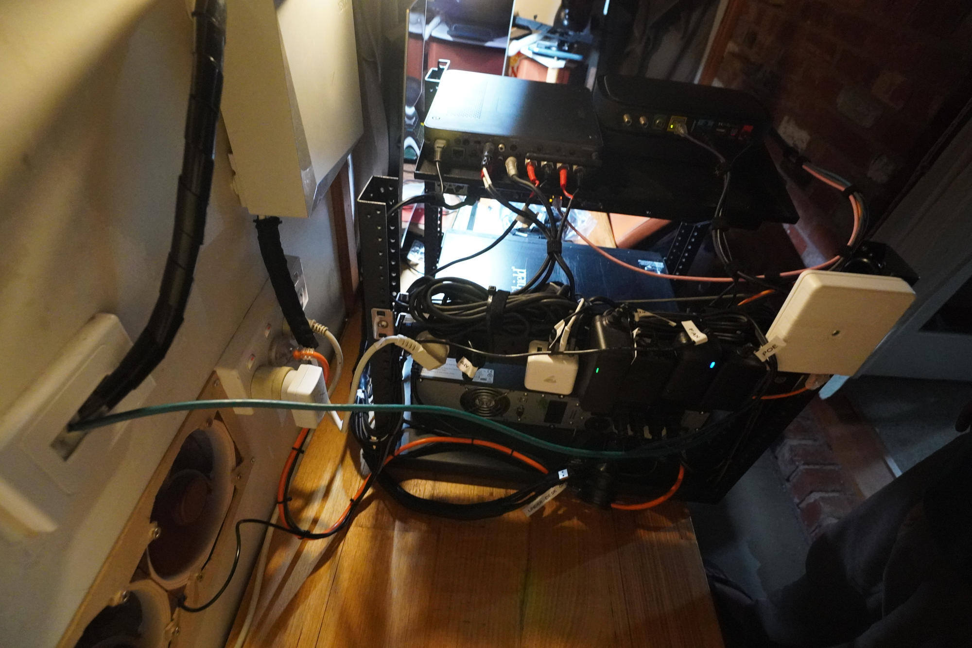

Fiber ONT is adjacent to rack and mains GPO is behind the rack, additional ethernet
run is also behind rack, cabling has been done as neat as possible, and an
under table shelf has been used.

Rack Layout
UPS
PowerShield Centurion RT 1000
PSLCERT1000_CenturionRT1000LiFePO_Horizontal.thumb.png.dfc8e5452e80b4cea3924a2b263cd609.png
An Australian company with a good reputation for UPS's, I Chose this model for
its short depth in the rack and dense battery capacity. A 1000VA online UPS with a
max load of 900w, typical idle is 25% with everything on inc workstation
or 50% under load/gaming.
Router
Mikrotik RB2011UiAS-RM
Mikrotik has been great does everything you'd expect from an enterprise solution,
this model can keep up with my 1gbps connection in fast-track mode, aka i'm limited
adding firewall rules, at this time i have no use for the firewall however this router will
be replaced should i find the need. My first purchase of a Mikrotik device was a hAP ac lite
followed by the mAP lite at a Mikrotik conference.

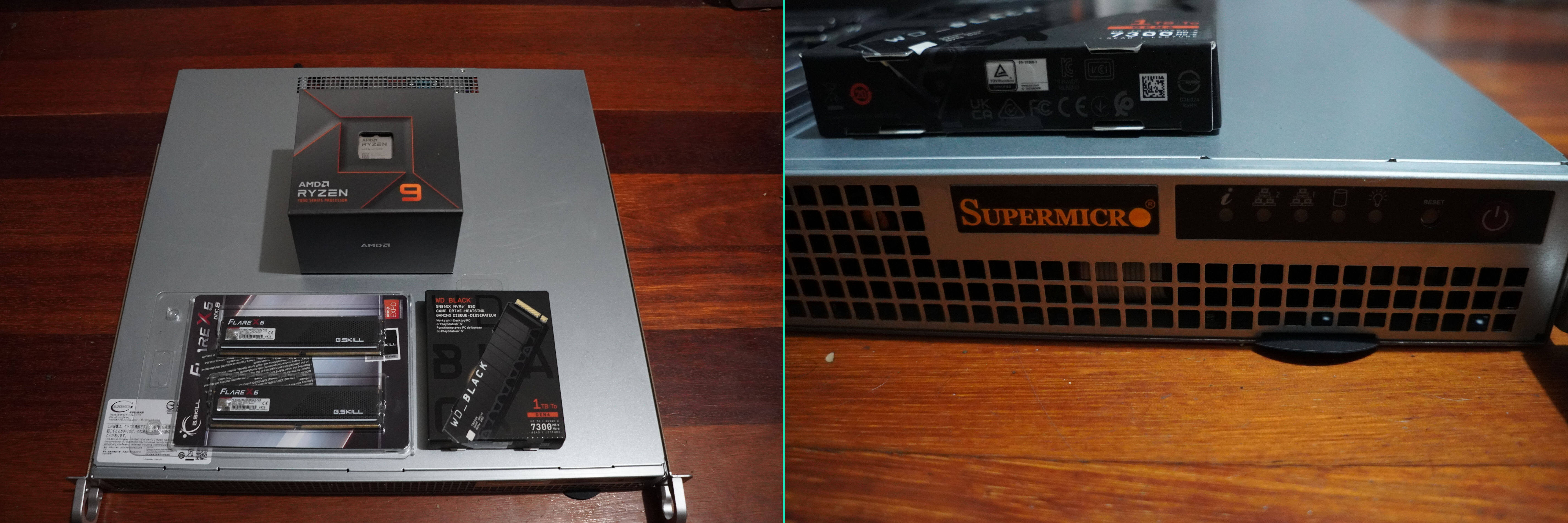

Server
SuperMicro Superserver 5018A-TN4
A low powered server to do a few basic functions, shown in topology map, all ssd
storage. The 5018A-TN4 barebones kit comes with rackmount case, motherboard
A1SAi-2750F, CPU Intel Atom C2750, fan. Additions I added where Ram 8GB, HBA
LSI 9200-8i, 2x HDD Bracket’s modified with drill for additional screw holes to
fix 4x 2.5” drives, Boot 120gb, Storage array 5x2tb RAIDZ-2, Jail/VM Mirror 2x240GB
Shelf Devices
    • Foxtel iQ4 (Cable TV), goes to 22" monitor on swivel above my bed with soundbar/subwoofer
    • Amplifier Yamaha WXA-50 for computer bookshelf speakers/subwoofer
    • USB Power Hubs (5 usb-a, 2 usb-c)
    • ZTE MU500
Power
  • Mains is fed with an orange AU Plug so it's easily identifiable
  • 4 IEC ports on UPS, workstation, server, one's a spare AU plug, and one plug goes to the 8 port GPO
  • 8P GPO rack mounted (2 additional 2 way splitters are used as i ran out of ports) [note: buy second 8P GPO]

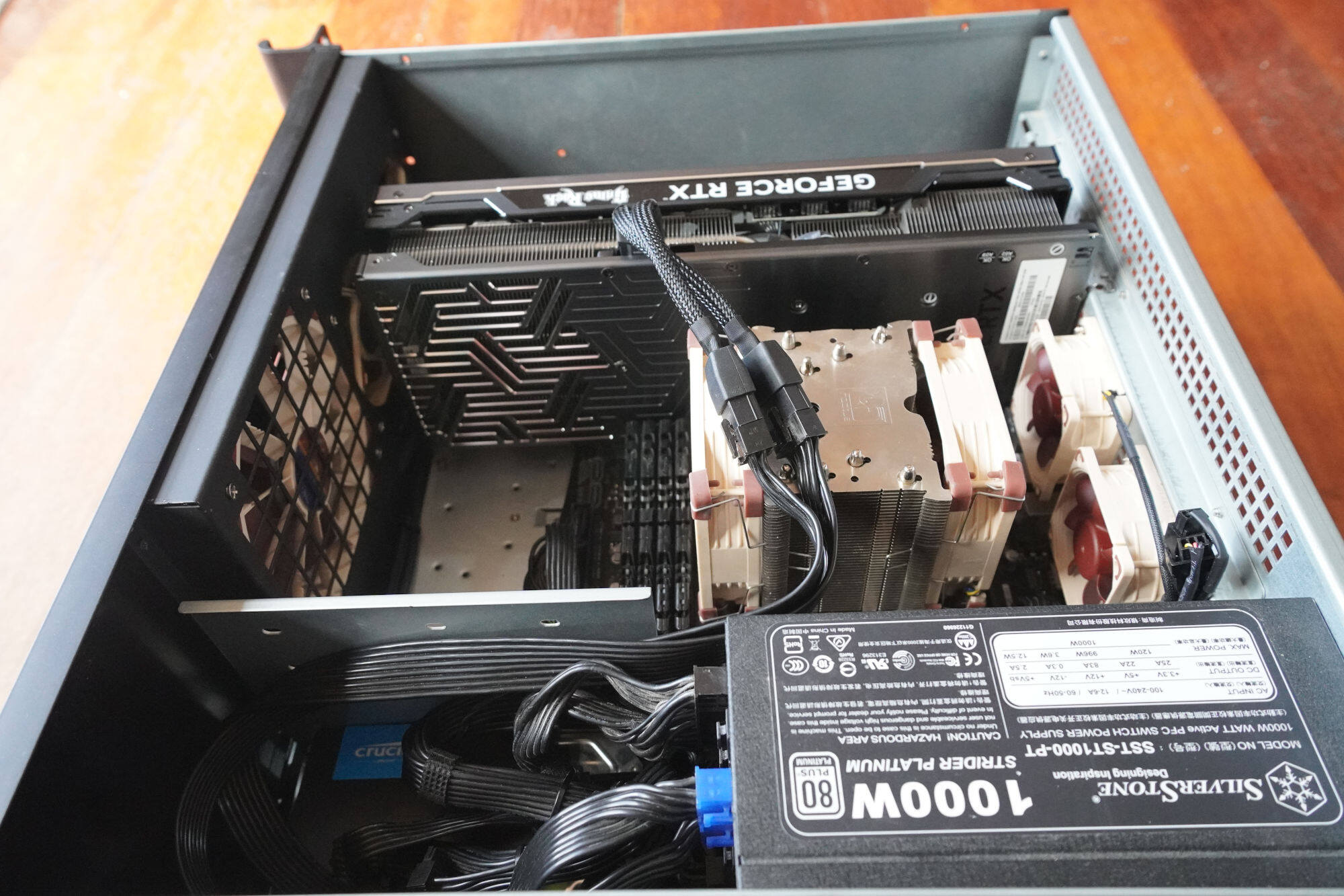

Workstation

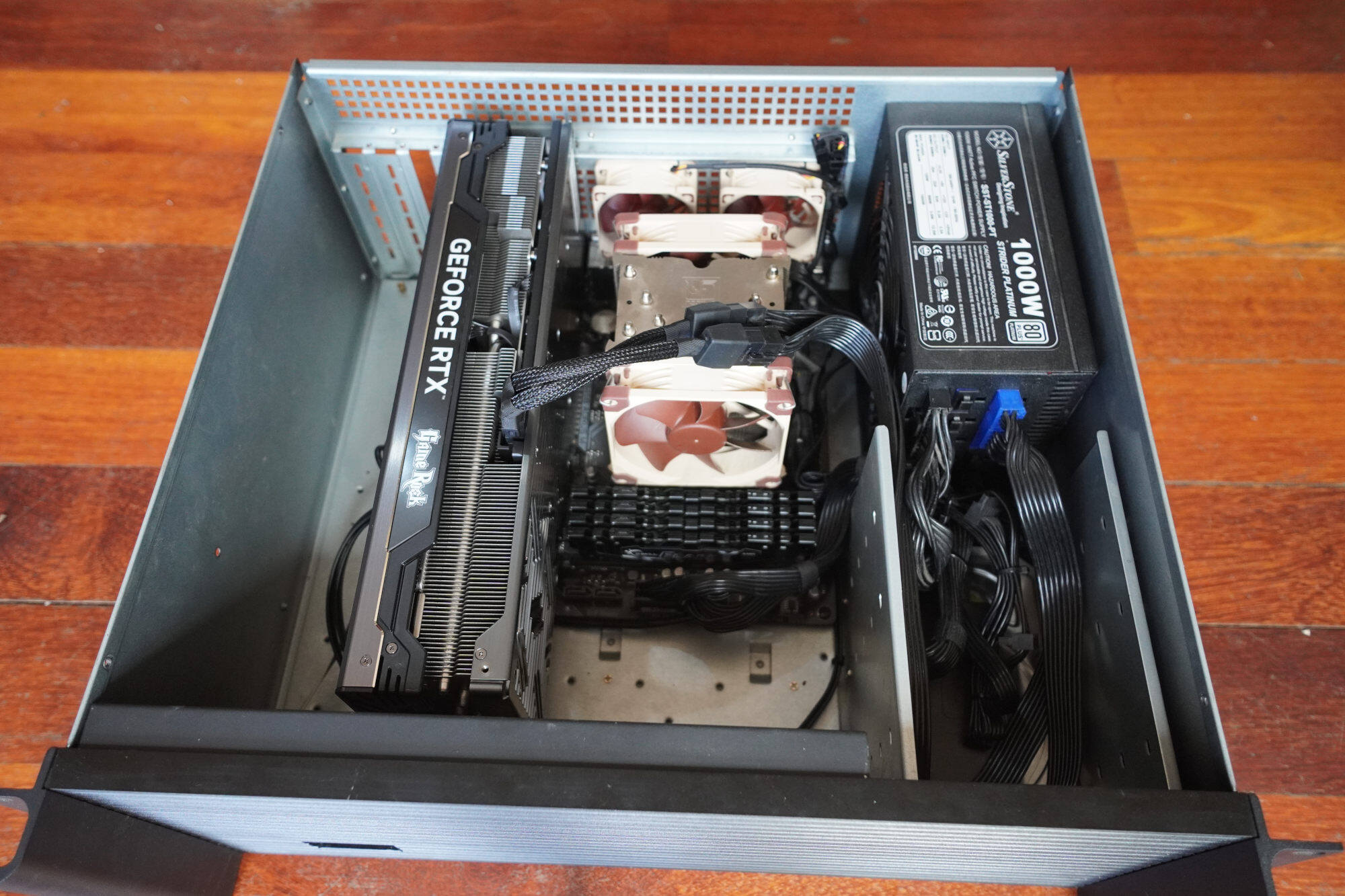

OS
    • MX Linux 23
CPU
    • x86_64-v2 AMD 5800x
Motherboard
    • B450 AORUS M
Graphics
    • 2080 Ti
PSU
    • SilverStone ST1000-PT
RAM
    • G.Skill Flare 32GB 4xF4-3200C14-8GFX CL14-14-14-34 1.35V
NvMe
    • 2TB TM8FPK002T
HDD
    • 8tb Seagate Barracuda
CPU Cooler
    • Noctua NH-U12S

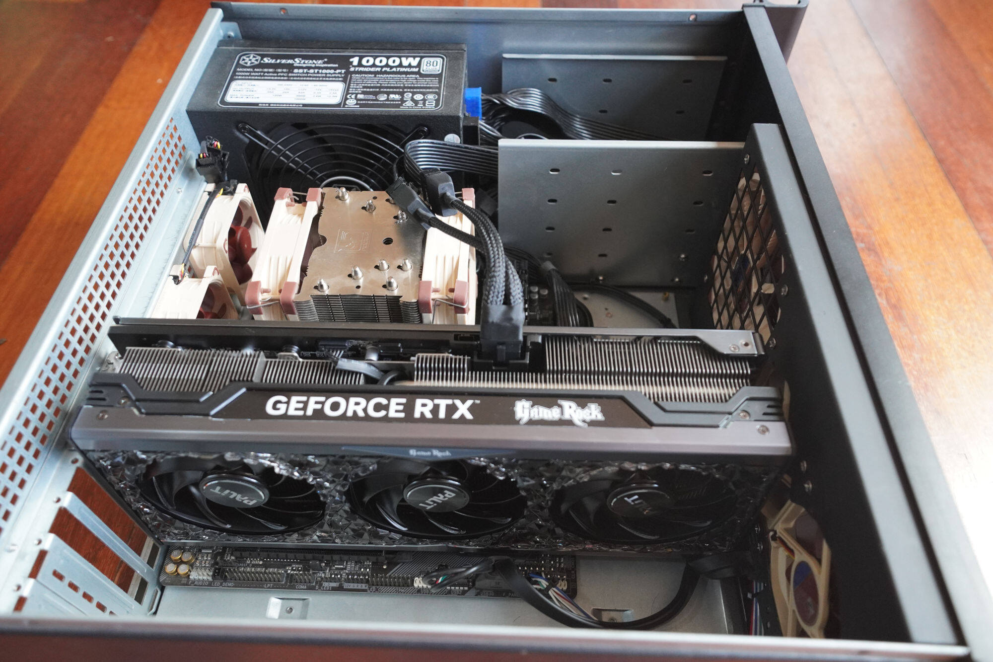

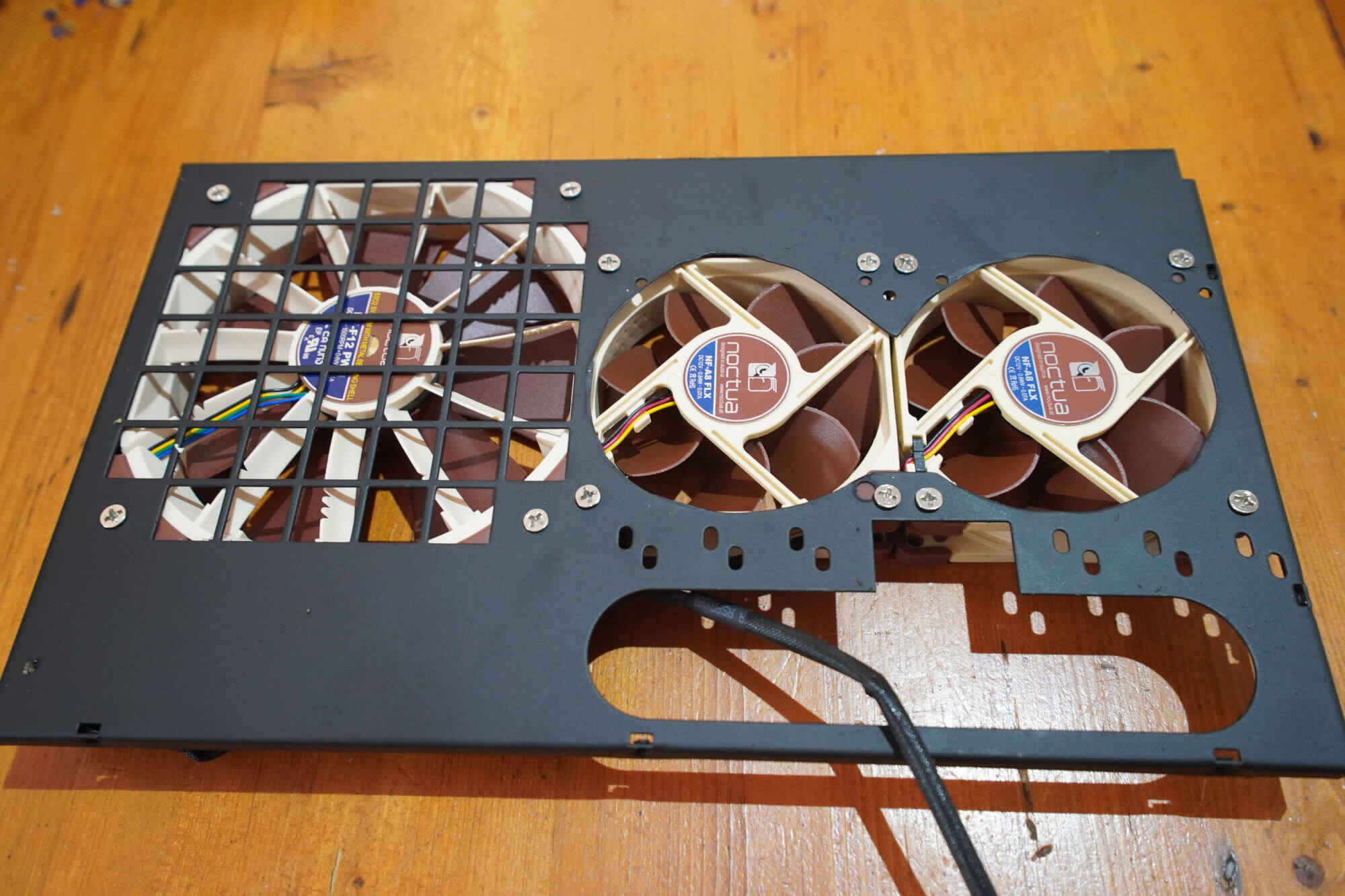

Case
    • TGC-43901 with generic fans 1x 120mm, 2x 60mm

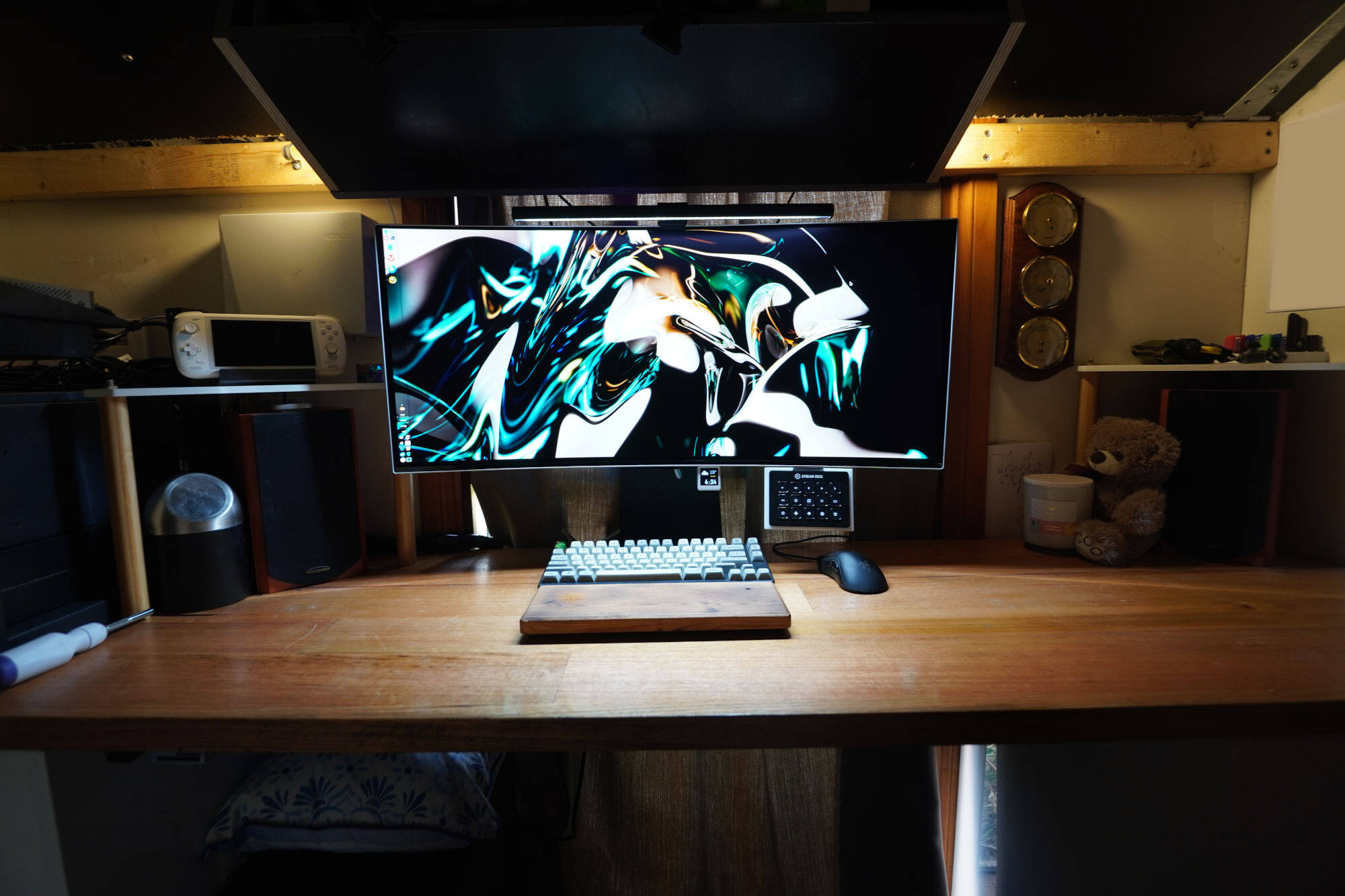

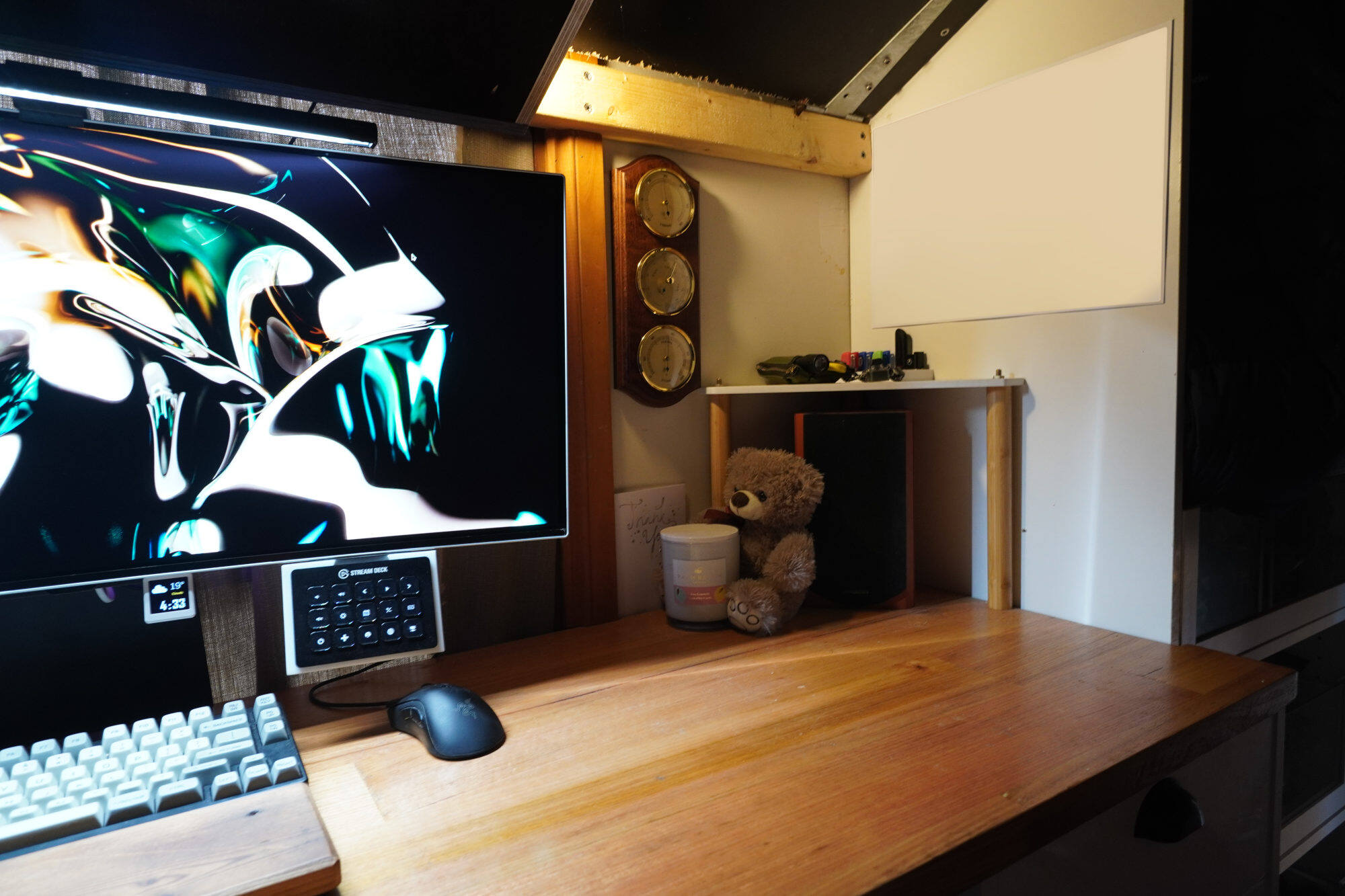

[ view from desk ]
[ rack top, sticker collection ]
[ rack front ]

I am so thoroughly impressed by everything but the desk/beds construction and AC on the desk, wow. Also, what do you do with your rig? Make sure WW3 does not happen? The amount of redundancy when it comes to powering it is astonishing.
