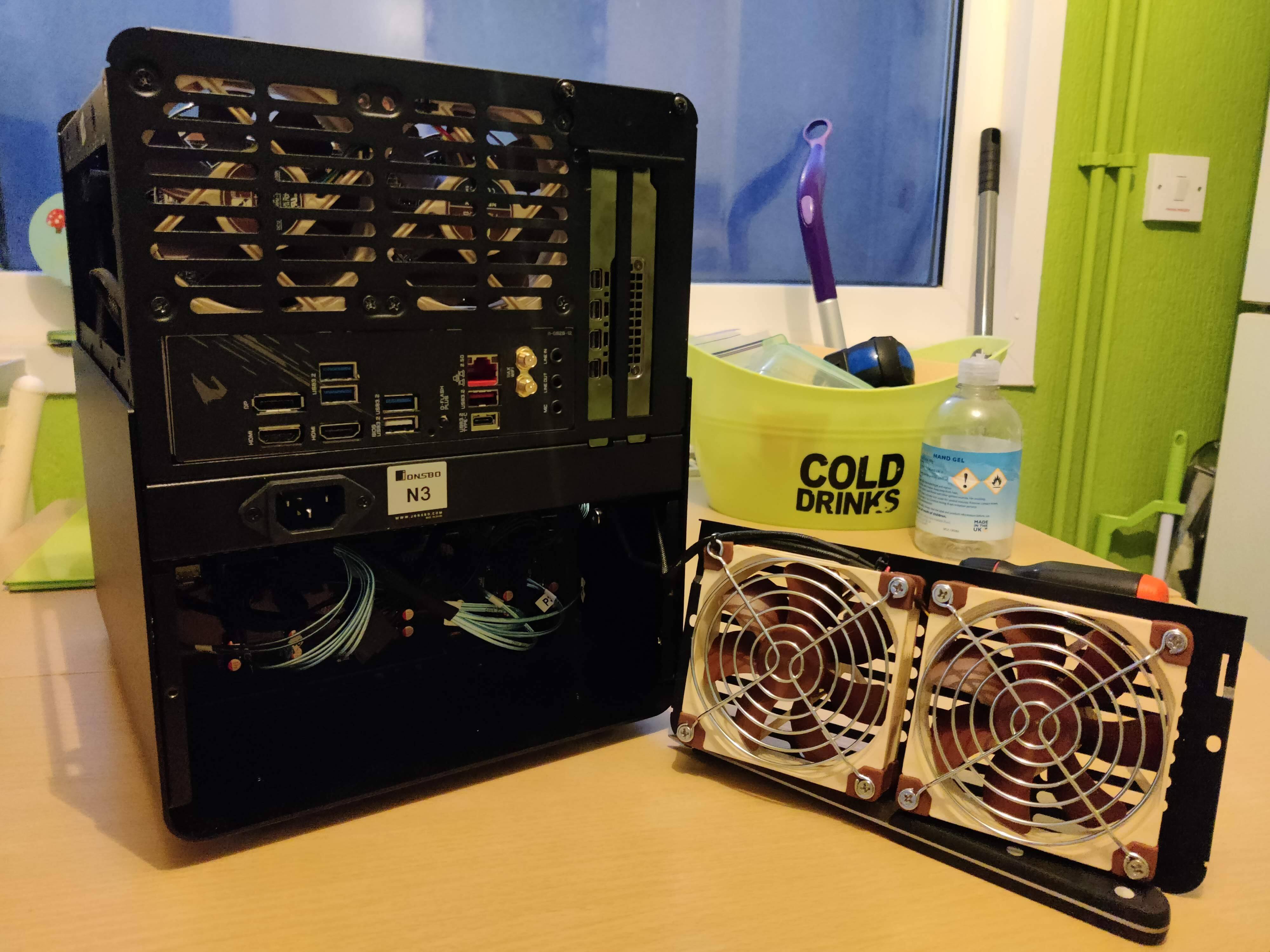

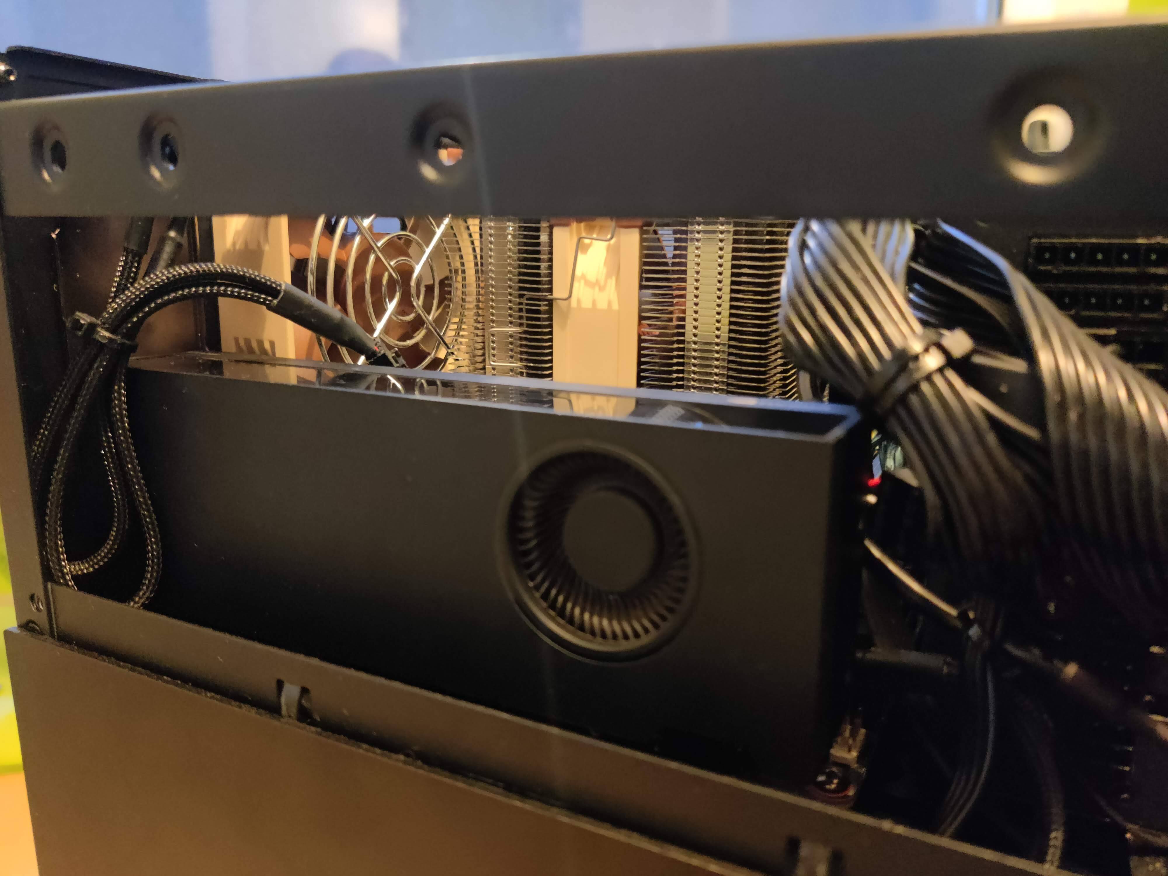

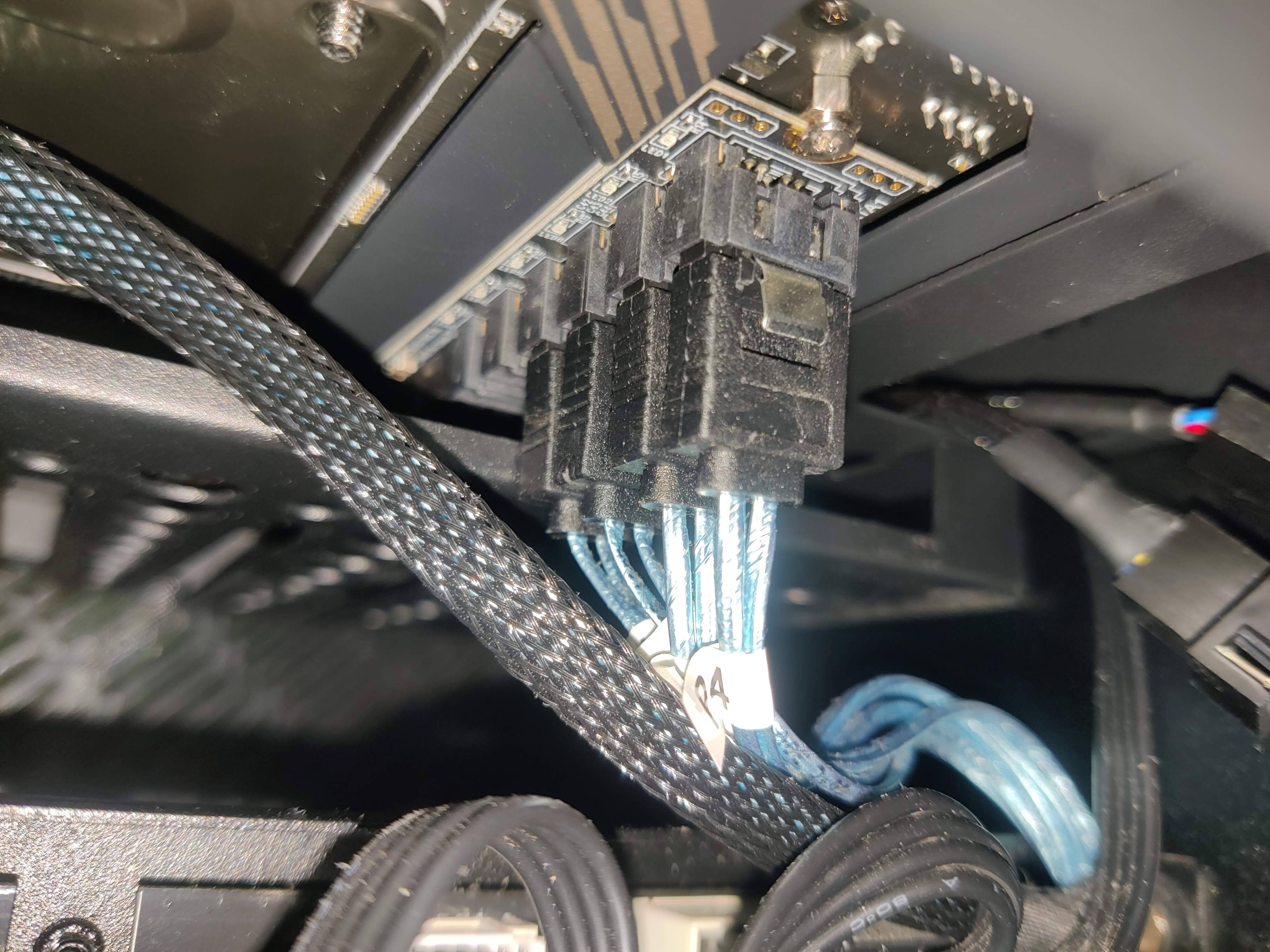

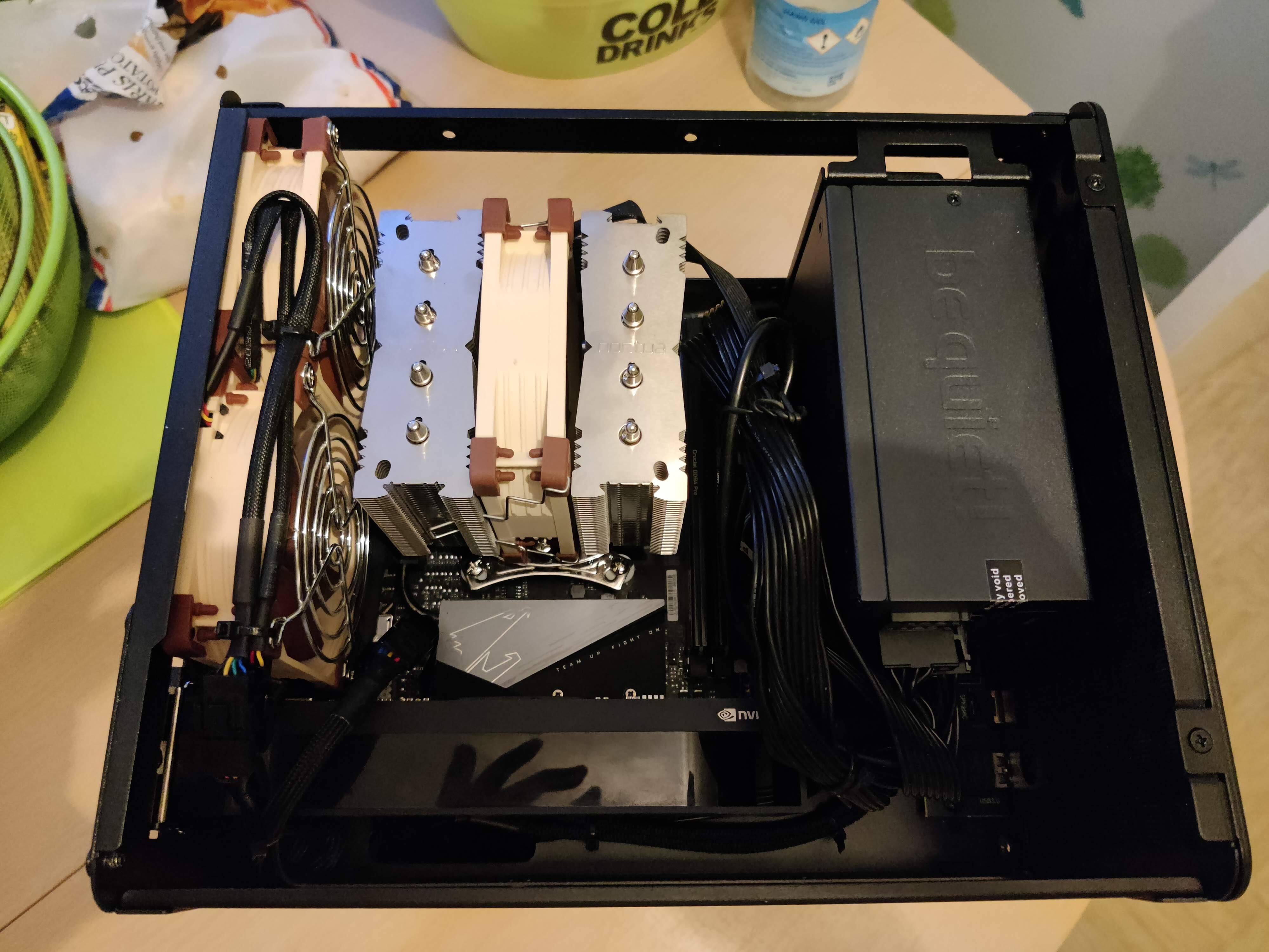

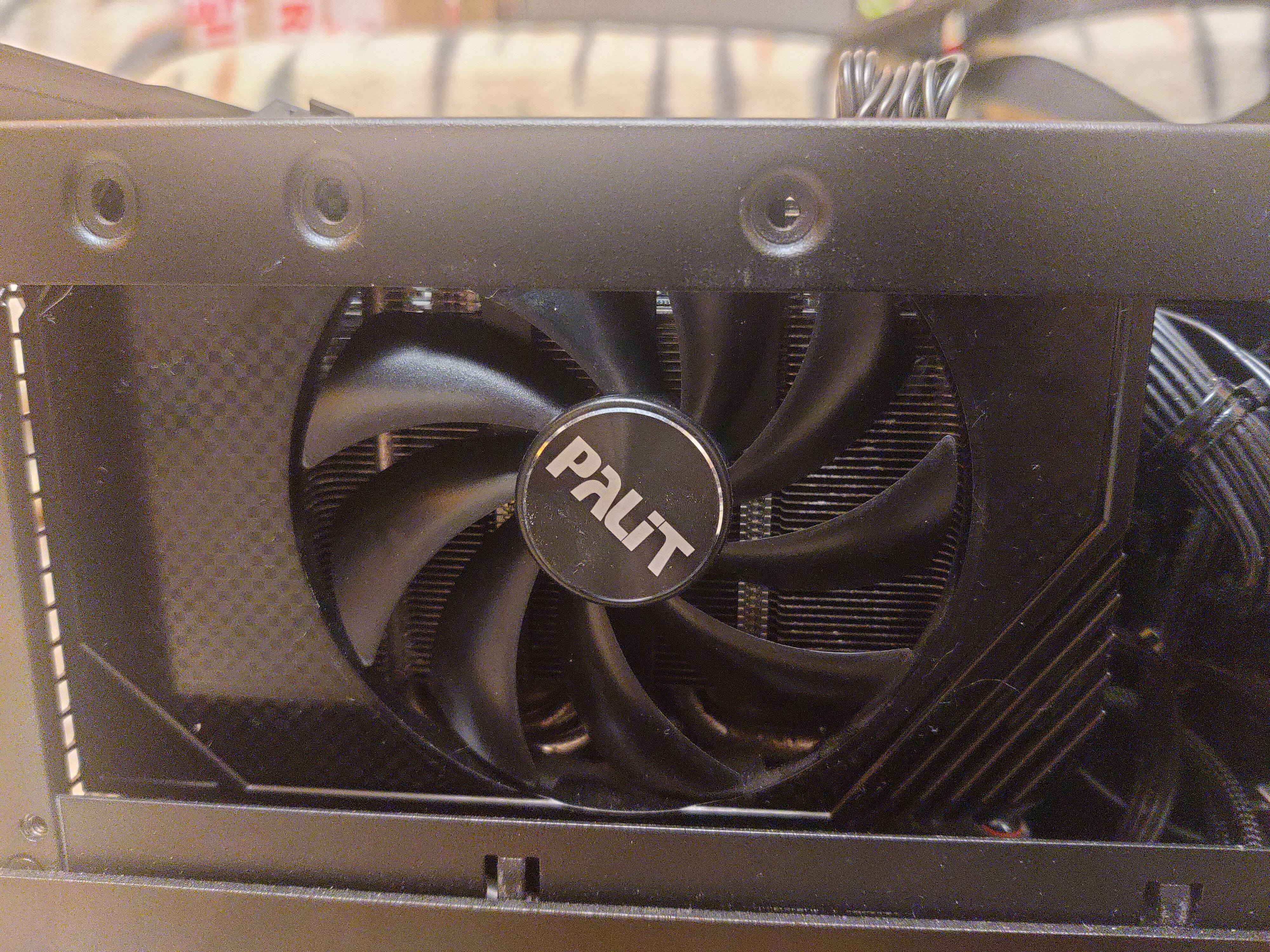

IMG_20231205_161655.thumb.jpg.6d8bb64dcfc95d06c8f6866fb66e13e4.jpgIMG_20231205_161422.thumb.jpg.51001a3a644eb6f435059b83406712fc.jpgIMG_20231205_161347.thumb.jpg.4d6d571b34bcbc623b90f1952df72875.jpgIMG_20231205_160806.thumb.jpg.e0ec76186d5fe96b7cc8834ef0ce63fa.jpgIMG_20231205_160652.thumb.jpg.9df6b34477be99754c6c75ffaad7a725.jpgIMG_20231205_160700.thumb.jpg.2ac60ddf01c6fa9a4ed6912a47492090.jpgIMG_20231205_161144.thumb.jpg.73ee667ece6a820508bdaf187d63aa2f.jpgIMG_20231101_105702.thumb.jpg.5c6e0f6bcfbfc07e7d5bfaa92df12078.jpg

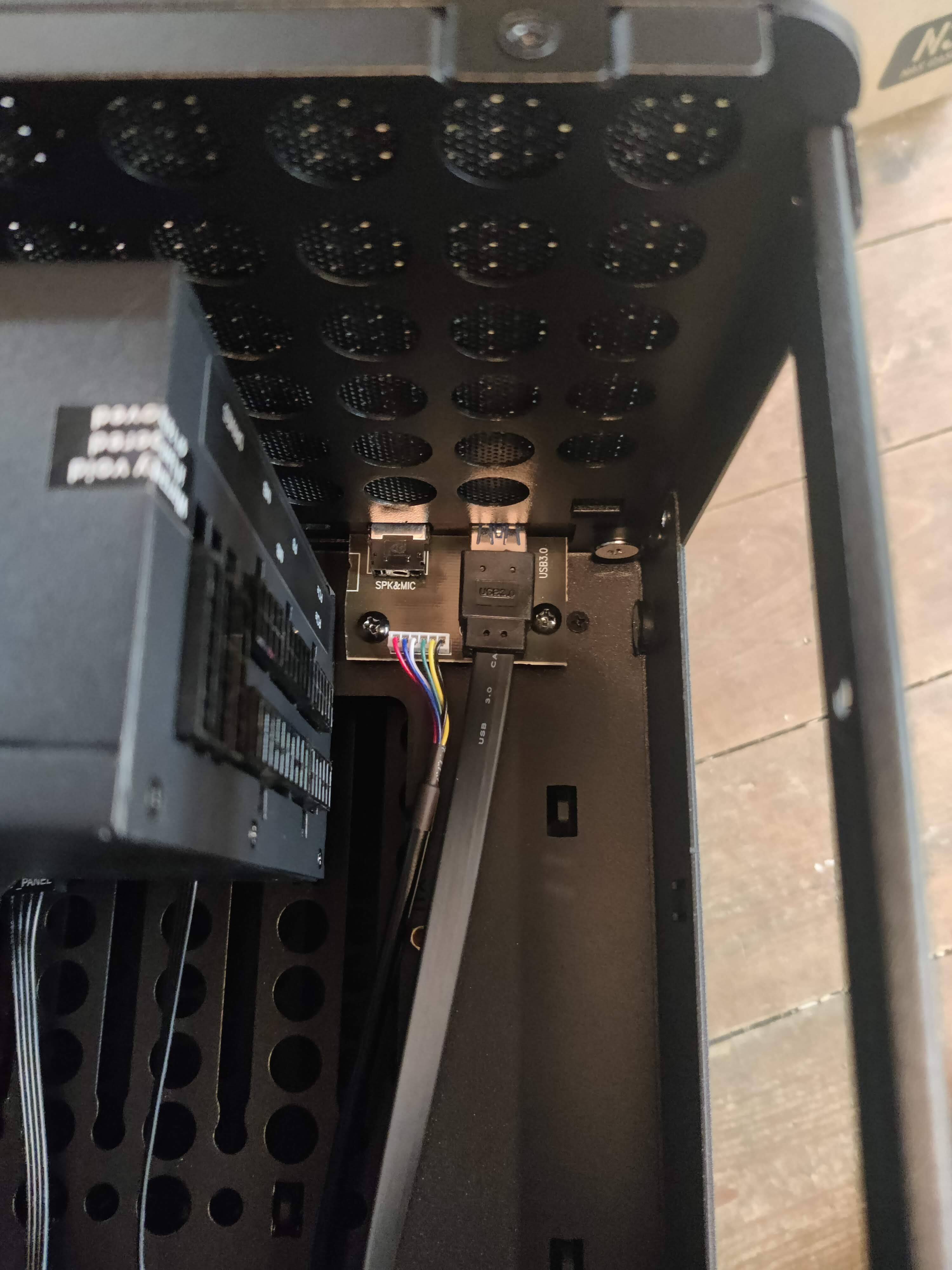

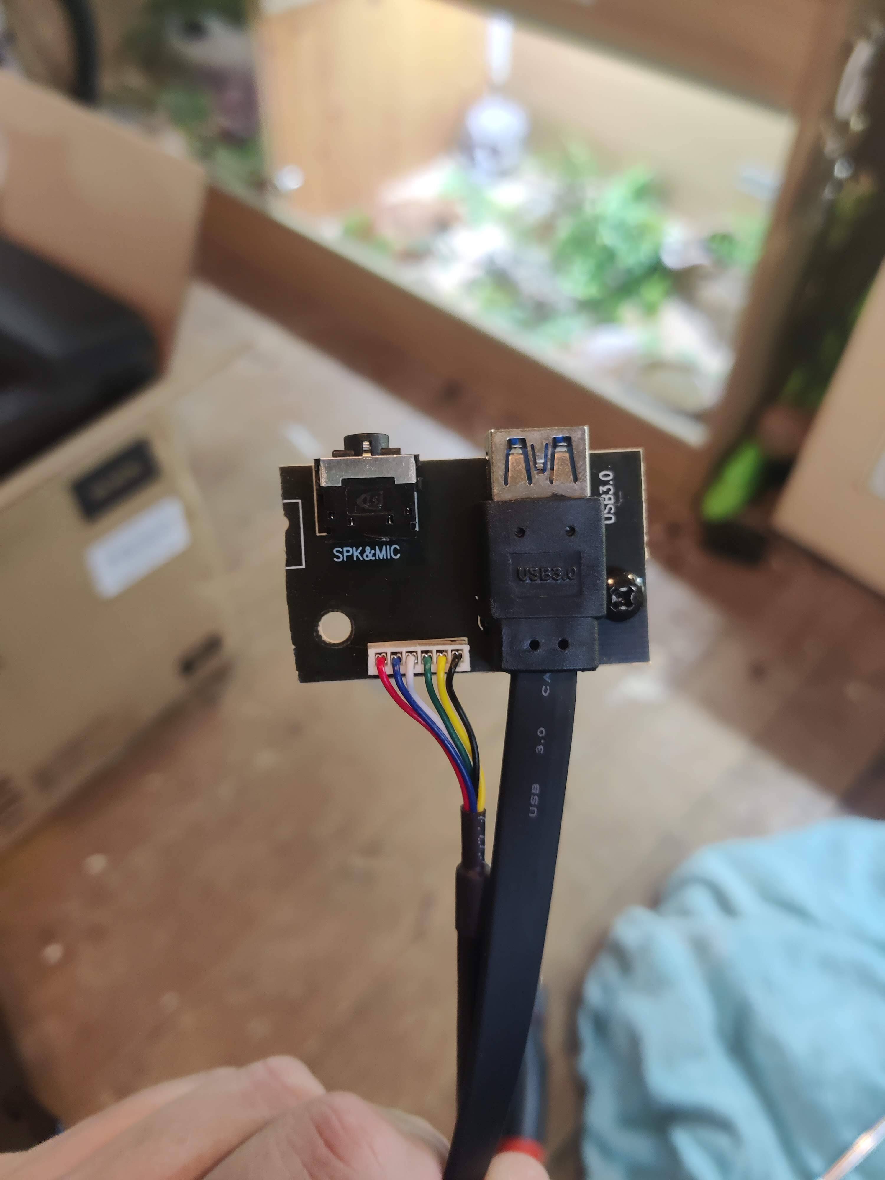

I ordered the wrong PSU SFX-L does not fit I could have just returned it but I want to continue building it after looking at I decided to remove the type c port from the front which unfortunately I had to cut the PCB that was holding (see pic below) it's not the end of the world the motherboard didn't even have the connector for the type so I was happy just to lose it
