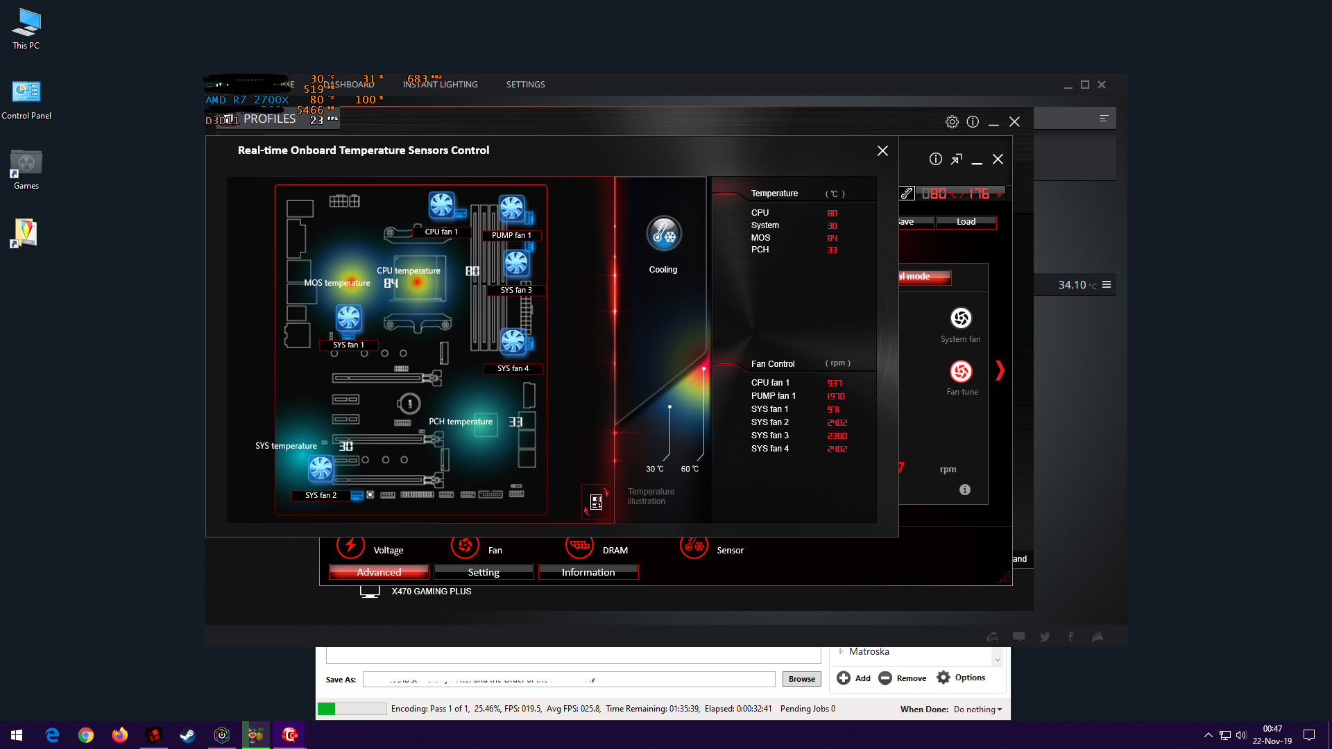

Hey, I didn't know where to post this, maybe I can still get the help I want. I am encoding a video and my temps are pretty high, and saw on other forums that my CPU temps should be fine. Other videos have been encoded before, and I did not check the temps until this session. Only recently did I find out what MOS meant, but, I have not found anything on the safe temps for it. I have an MSI X470 Gaming Plus motherboard with a AMD Ryzen R7 2700X CPU my cooling method is a Corsair H100i V2 water cooler. Any info on temps and safe areas for the temps plus tips on the future would be greatly appreciated. I thank you for taking the time to read this. Thank you in advance for helping me.1830119869_DesktopScreenshot.thumb.png.31f198668434cd5bc01e3e21a68b2609.png

What do you have running that is causing you to have your CPU at 100% usage? That is likely the cause as its causing the mosfets and VRM to heat up as a result of the load.

6 minutes ago, Wolf918 said:
Handbrake. I am encoding a video.
You could try to improve airflow in your case and/or add a fan for the VRMs specifically to keep them cooler. A quick Google tells me the safe temp is 175°C, but I'm not sure how reliable that is. Plus, even if its safe for the VRMs, it might not be for the components around them.
https://linustechtips.com/topic/1124221-mobo-heating-up/#findComment-13050584
@Eigenvektor Thank you, I will hope that 100c is ok. As I stated, other videos have been encoded already, and I have not checked the temps before. I hope that, in the picture I posted in my topic, the spot where the MOS is, is safely away from my other components. Airflow has been, in my opinion, optimized. Gaming temps are pretty low, rarely goes past 57c for my CPU.

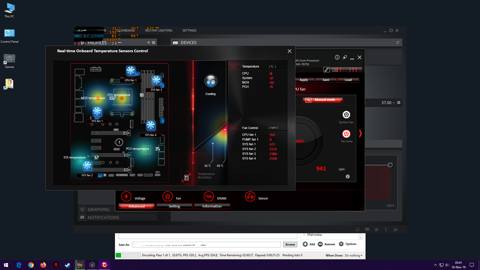

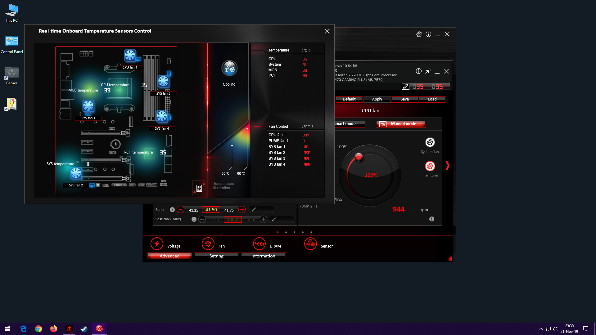

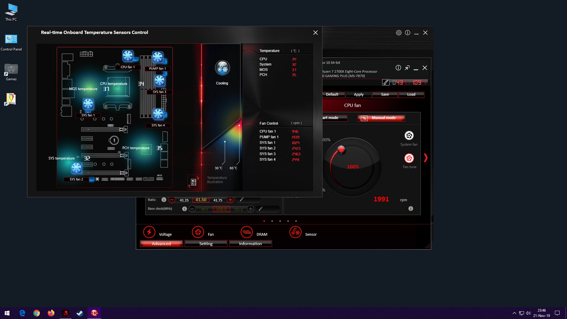

For those of you who were interested in the follow up, here is some pictures. The first picture is no fan attached to the rear exhaust fan with L brackets, idle for 15 minutes. The second picture is 15 minutes with the fan attached to the rear exhaust fan, still idle. The last picture is me encoding a video with the new attachment setup. Idle meaning, the computer is just... on.
EDIT : Corsair ML140 fan is attached to the rear fan, I forgot to add that detail.
