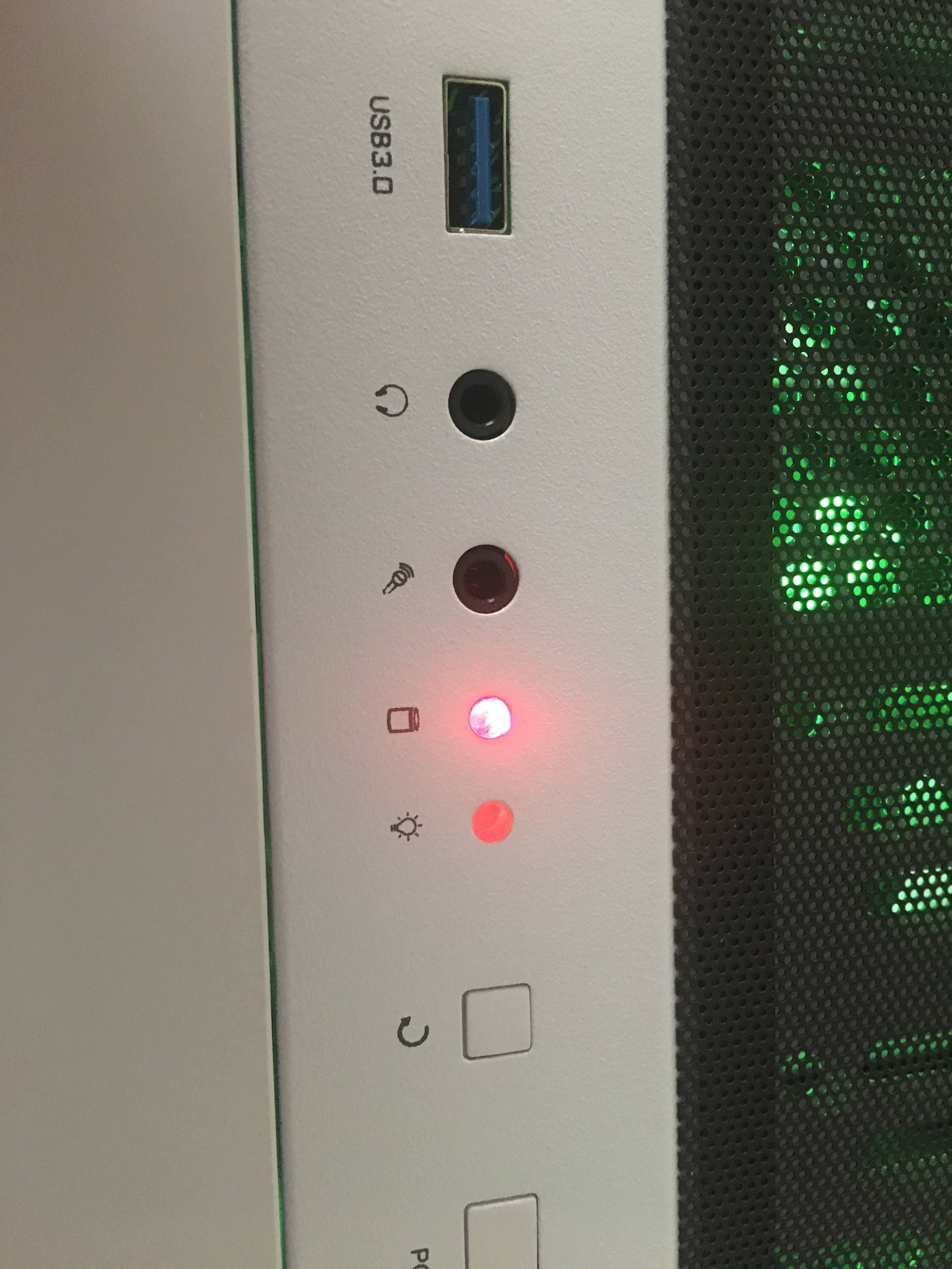

Another question sorry if I ask a lot. This red led on top of my case now blinks red when before only the led below it flashed and it was blue any idea? Or at least what does it mean?
That's the HDD status LED, they probably didn't have it hooked up the first time. It blinks based on the use of the HDD.
Even if I have two M.2 SSDs? Also I did the whoile DDU and GeForce deal and NMS ran fine for a few minutes. I'll have to test it later as i have to go to work now. You sir have been a great deal of help and wish I could buy you a beer. I'll post an update about the crashing after I do some testing.
Yeah just let me know, typically with SSDs the HDD light will still function it's just more stable, it may blink or flash every once in a while but for the most part it will be pretty solid. If you have a mechanical HDD it blinks quite a bit.
