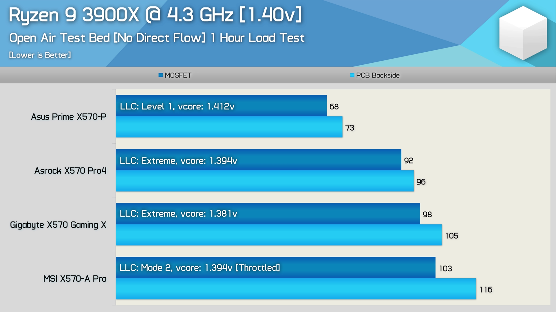

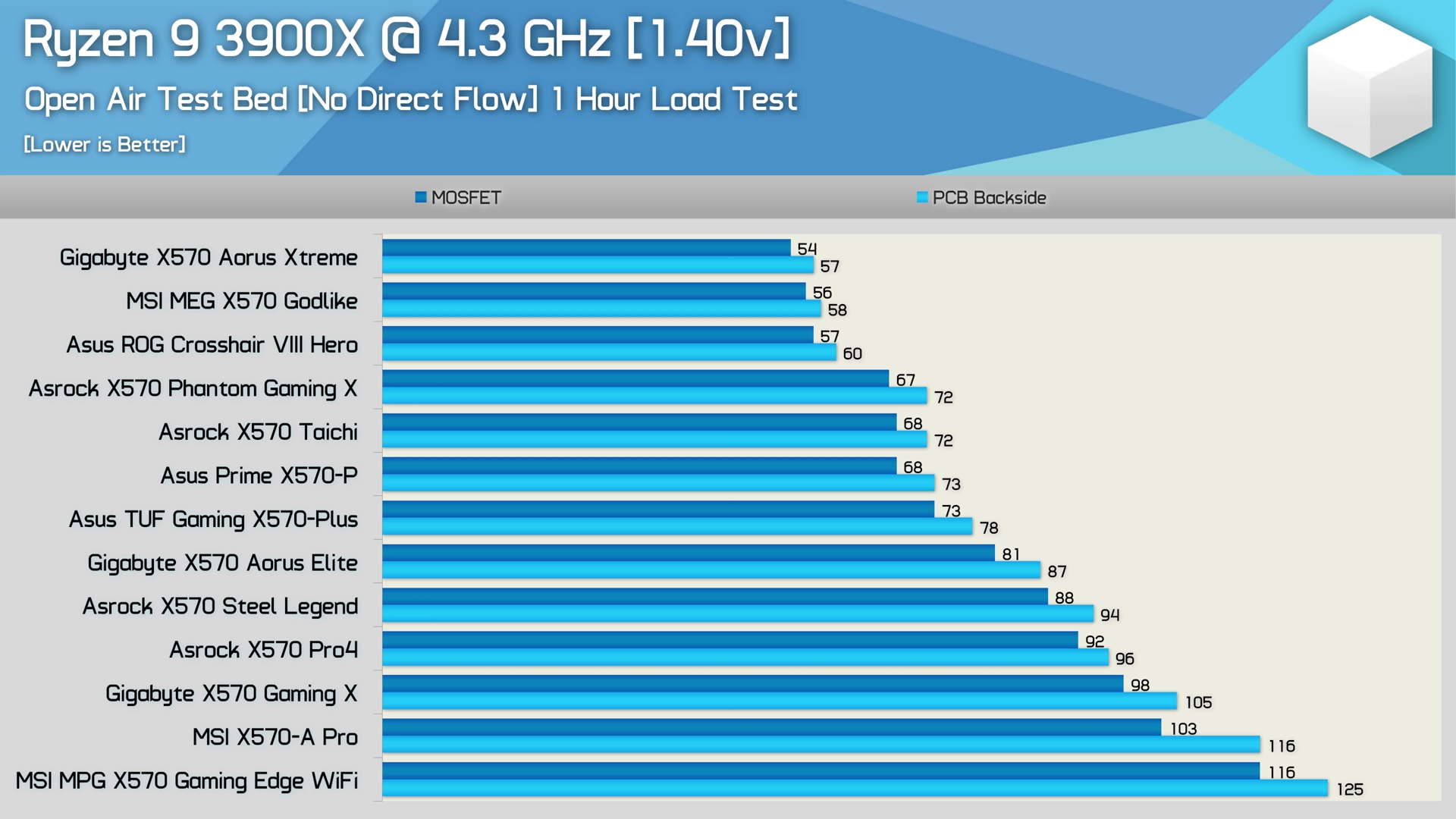

I would go with the Gaming X from Gigabyte instead, cheaper and has better VRMs over the Aorus elite so if you ever decide to dabble with overclocking you'll have a better experience. Also swapped the RAM for some LPX 3600 memory because it's $1 less than the 3200 kit.

Then again for the price point if VRM is a must concern the ASUS Prime-P wins the cake

So it looks like the ASUS Prime-P and the Gigabyte X570 GAMING X are the exact same price right now and I can't find any real differences from the Asus or Gigabit websites. Is there something I'm missing?
I think why I chose the 3600 memory is because of the greater latency (18 vs 16), but I never was able to figure out if latency is even something to worry that much about. I guess the greater clock speed makes up for that?
Yah, I don't think there is much difference between the boards. Nothing that stands out to me anyway.
For memory I think 2ns of latency will more than be made up for by the additional clock speeds from 3200 to 3600, especially with Ryzen.
